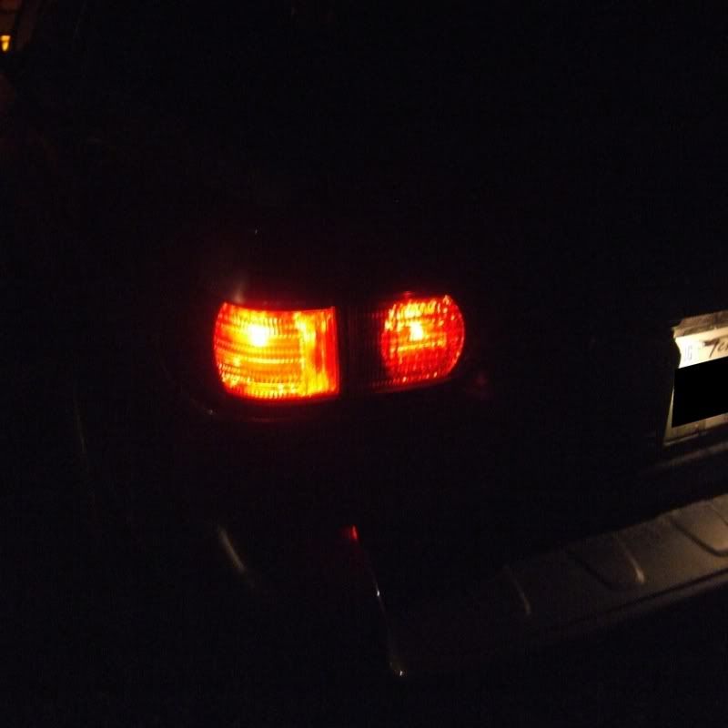

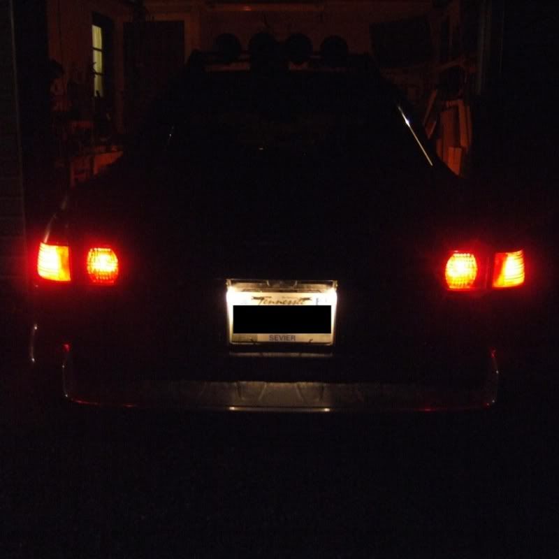

good call on tinting the taillights, im sure they look better in person. did you use that VHT stuff? If i had any black on my truck, id definatly tint mine. I want to do my wifes taillights, but im worried i might waste my time and money on that VHT stuff and have it not turn out that great. is it easy to apply? Its that Nightshades stuff right?
Re: video of my Baja getting hit at gas pumps - 8/29 FIXED!

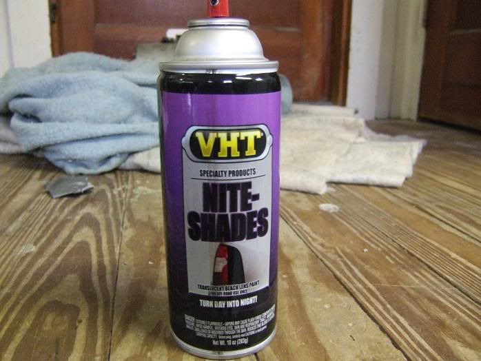

This is the stuff I used:
I just taped it off and sprayed it. If you make the coats too light you will get a "flat" type texture with it. Mine did a little bit but I shot some gloss clearcoat over them to give them a bit more shine. If you have a spare piece of plexiglass or plastic to test on it really helps to get a feel of how the paint lays. In RL it looks a lot darker and the tail lights look kinda cool at night as well.
I do however want to add another set of lights to the unused cavity in the tail lights for my backups. The backups on the Baja are a bit lacking IMO.
