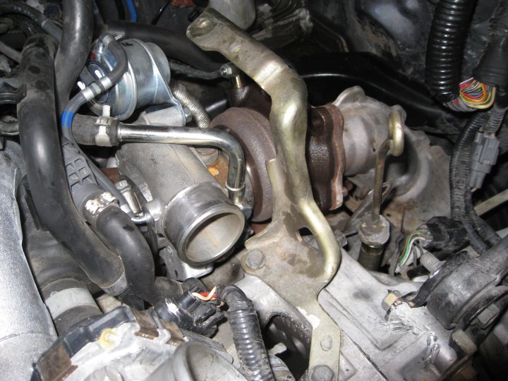

Thanks!, I gotta 2005 Baja that's got 106k miles on it, but a new engine is going in soon anyways and its already got a brand spankin' new Clutch, and Turbo
- here's a pic of the turbo
- baja3.jpg (91.95 KiB) Viewed 7426 times
My 2005 Baja is under construction and currently has no engine but my new engine comes this Tuesday
