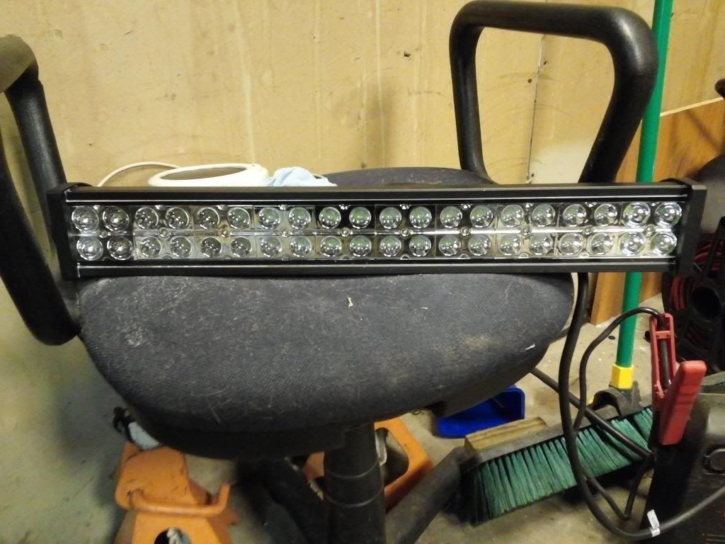

I decided I needed more light in the back. I have a little trouble backing up, which is weird since I had a Crown Vic with 5% limo tint for 5 years.
So I bought this..
http://www.amazon.com/gp/product/B009HV ... d_i=507846
I did not buy from that seller. I got mine open box for $90 off eBay.

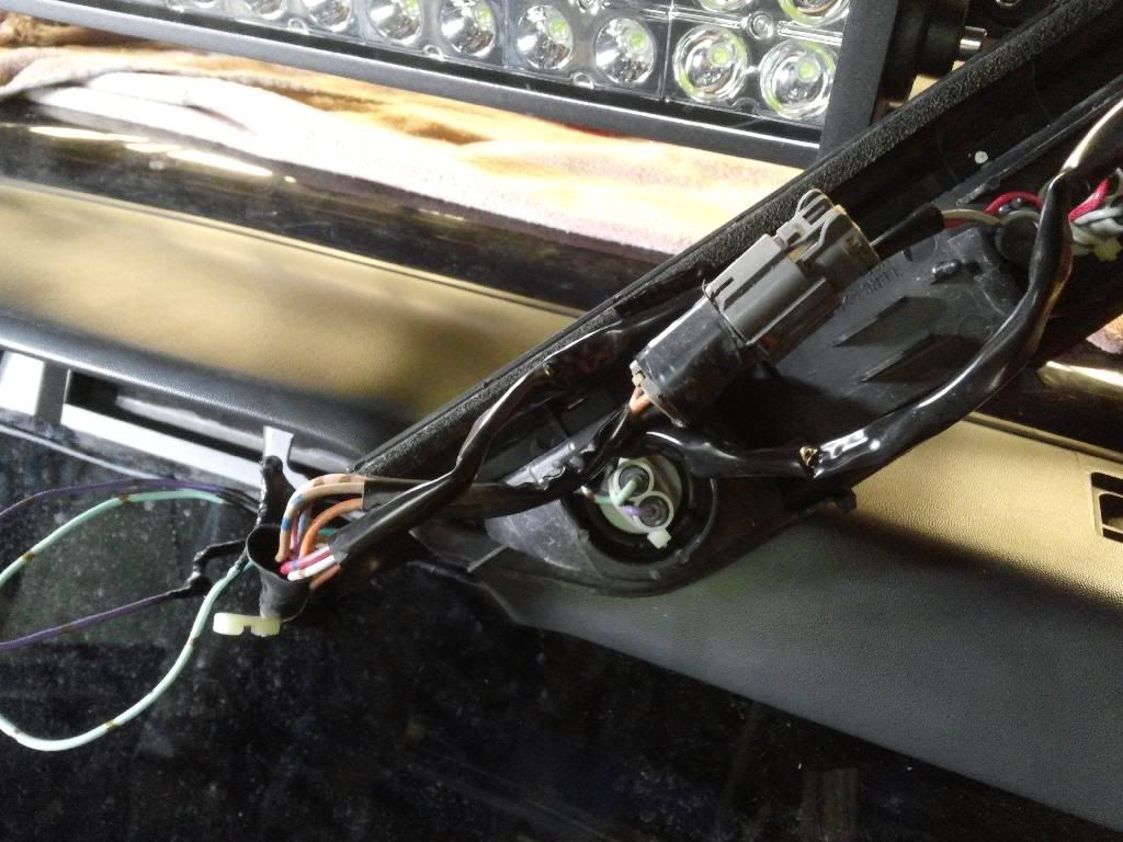

I used the cargo light circuit to power it. After examining the 16 gauge wiring and with a very good engineer buddy of mine we decided to use both B+ or hot wires to power it and tie both grounds from the cargo light, I wired the unit into that circuit. So with that button push I can turn it on.

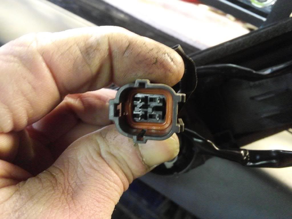

Passing thru the Activity light route. THIS SUCKED! The push pins we all know .... and lose

The wiring is soldered,liquid brush on electric tape,heat shrink tubed and then wrapped in Super 88 again.
