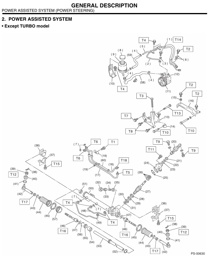

It’s an 05 NA. I did 40 ft pounds but I reused the crush washer since I forgot to buy a new one, naturally leaking a touch. Just got a new one and wanted to double check the spec first.

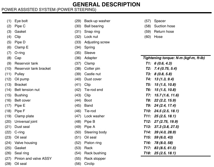

If I’m looking at the same bolt here (numbered (1), with torque designation T14), it’s only 28.9 ft-lbs.

20Baja06 wrote: Mon Mar 31, 2025 11:29 am If I’m looking at the same bolt here (numbered (1), with torque designation T14), it’s only 28.9 ft-lbs.
Thank you! Is there a place all those images are posted? I should just bookmark them if there is.

I pulled them from the service manuals, here: https://www.scoobytruck.com/bb/viewtop ... 082#p25082
I’m sure they are also available somewhere on https://charm.li/, but I didn’t have luck tracking them down in a timely manner.
