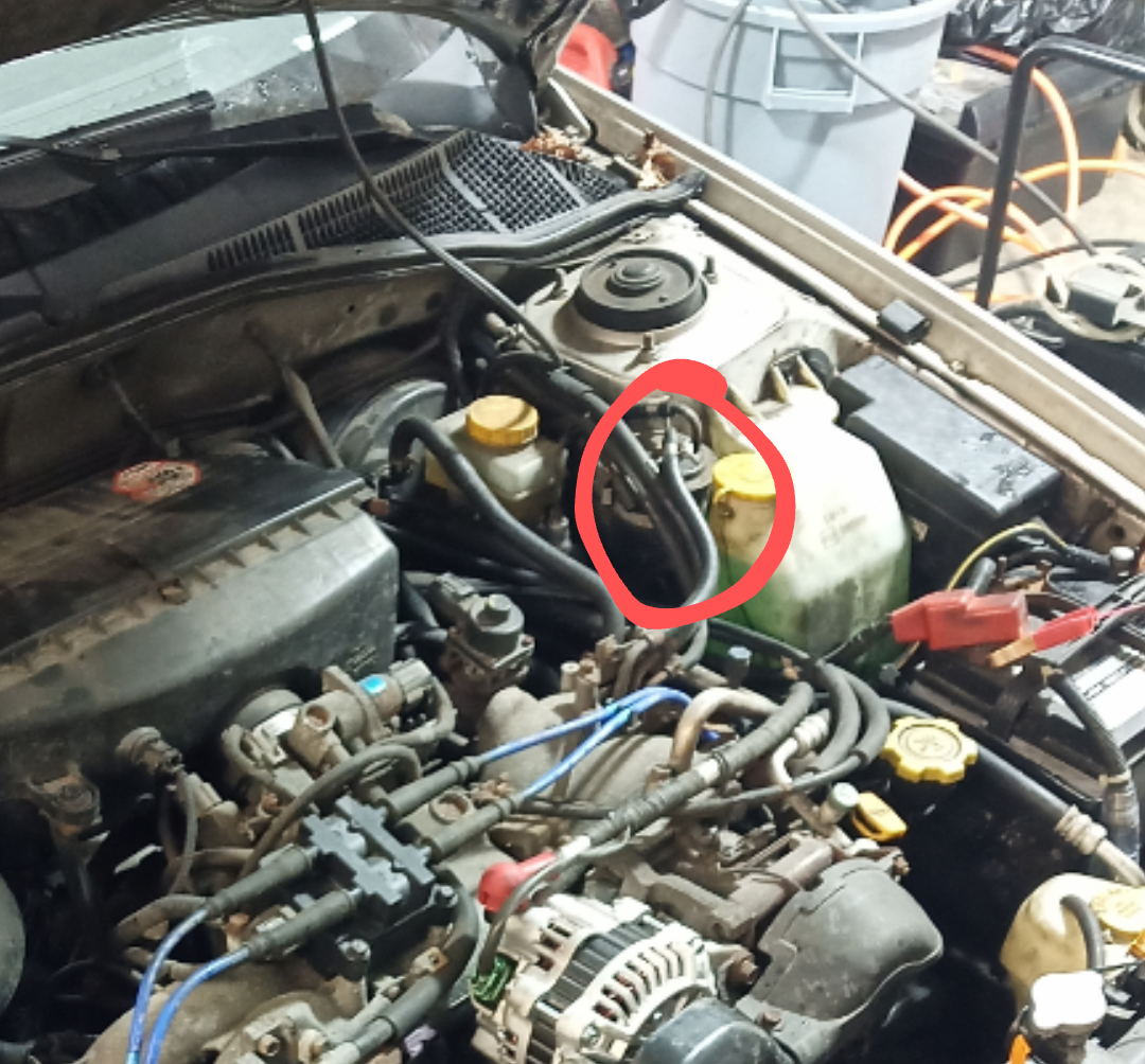

You said you checked the filter; how did you do that? You checked the fuel filter? In my 2003, it's a black cylinder with two short pipes near the driver's side strut tower, and there's no way to check it unless it's removed.

This is where the fuel filter is on mine (see attached photo).
If you don't hear the noise from the video (second one, from under the car), it's likely something to do with the fuel pump. It may not be the pump itself; could also be a fuse or relay.
