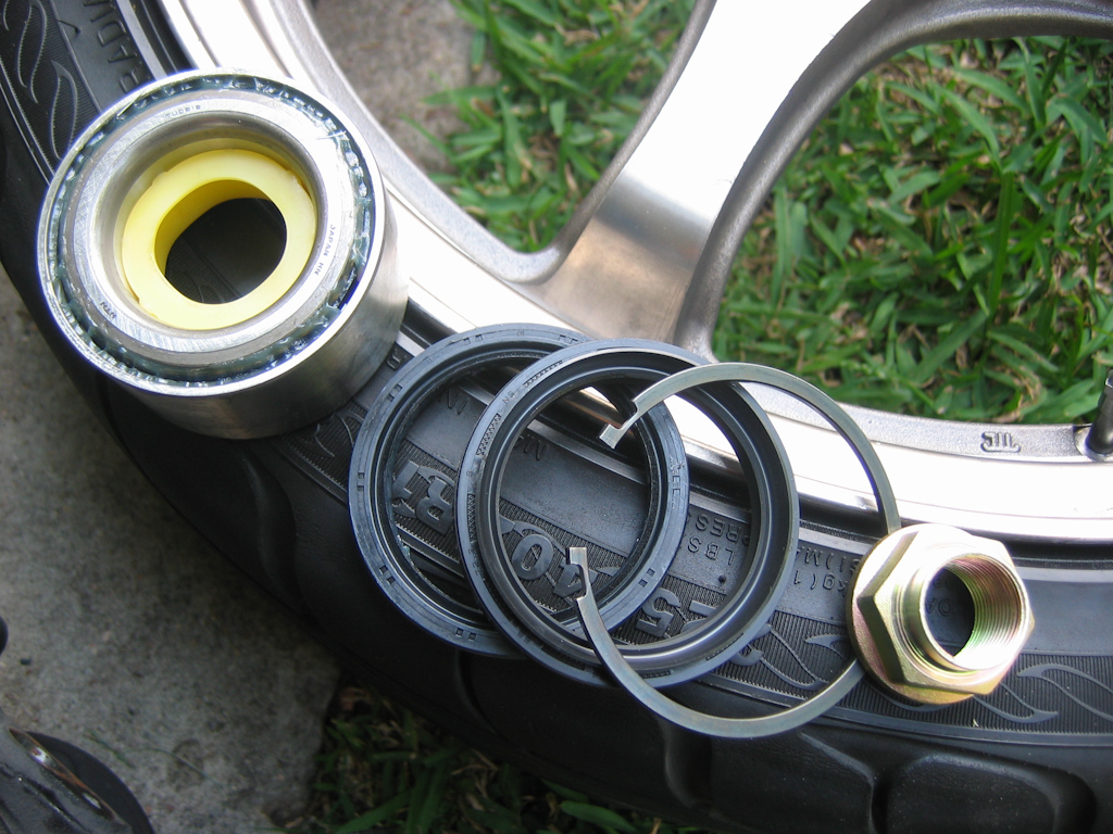

Howdy folks!
I've started to notice a roaring kind of dull noise coming from the front of my car. It happens pretty obviously as soon as I begin to turn the wheel to the right. Otherwise, when driving forward, it's relatively unnoticeable(but still present). As soon as I turn the wheel to the left, however, It goes away. Sounds like a wheel bearing, right?
SO I changed the wheel bearing on the Front DRIVER's side. To my dismay, the sound continues. Any suggestions on how I should move forward would be super appreciated! [smilie=666.gif]

passenger side bearing. axles don't usually grind. I worked in a shop for a few years and saw the same thing happen several times. one of them, a coworker swapped bearings twice and got my attention with colorful language about bad parts out of the box when I stopped him and helped him troubleshoot and found the other side was actually the bad one.

kamesama980 wrote: Thu Nov 23, 2017 9:50 am passenger side bearing. axles don't usually grind. I worked in a shop for a few years and saw the same thing happen several times. one of them, a coworker swapped bearings twice and got my attention with colorful language about bad parts out of the box when I stopped him and helped him troubleshoot and found the other side was actually the bad one.
Brilliant! I'm looking at each of the bearings and the passenger side does seem to be a little more clunky when pulling the wheel at a "3 and 9 o'clock" position".
The sound I'm hearing when I'm driving though, that sound wouldn't be caused by a bad lower ball joint, would it? I was looking around and found a ball joint on the transverse link of the driver's side to be pretty leaky and sad looking.
