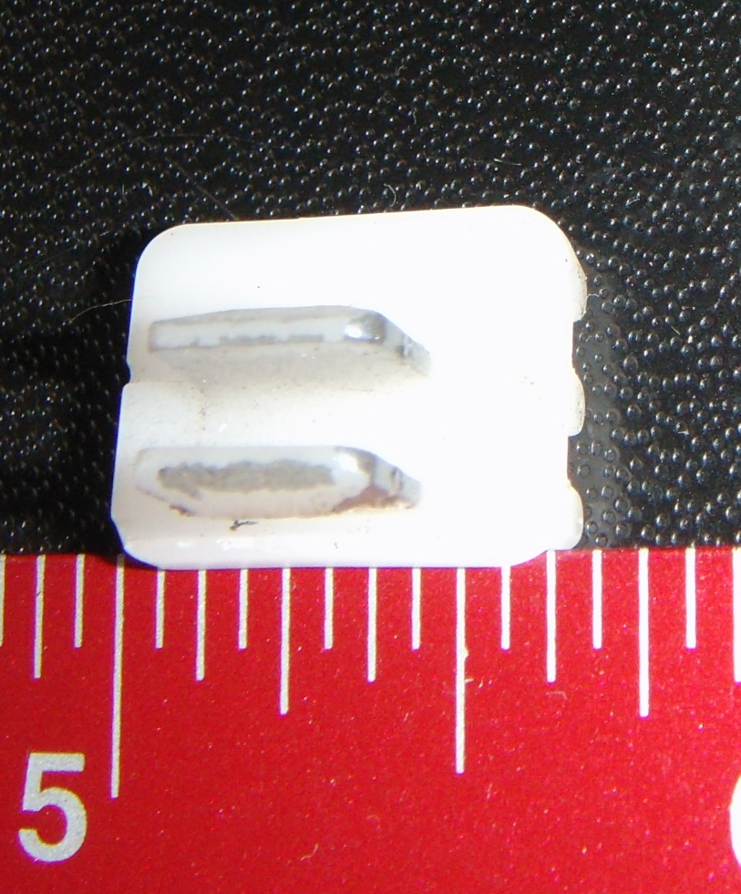

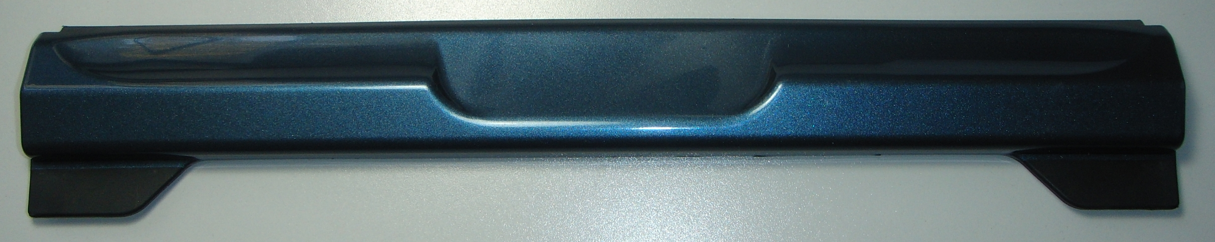

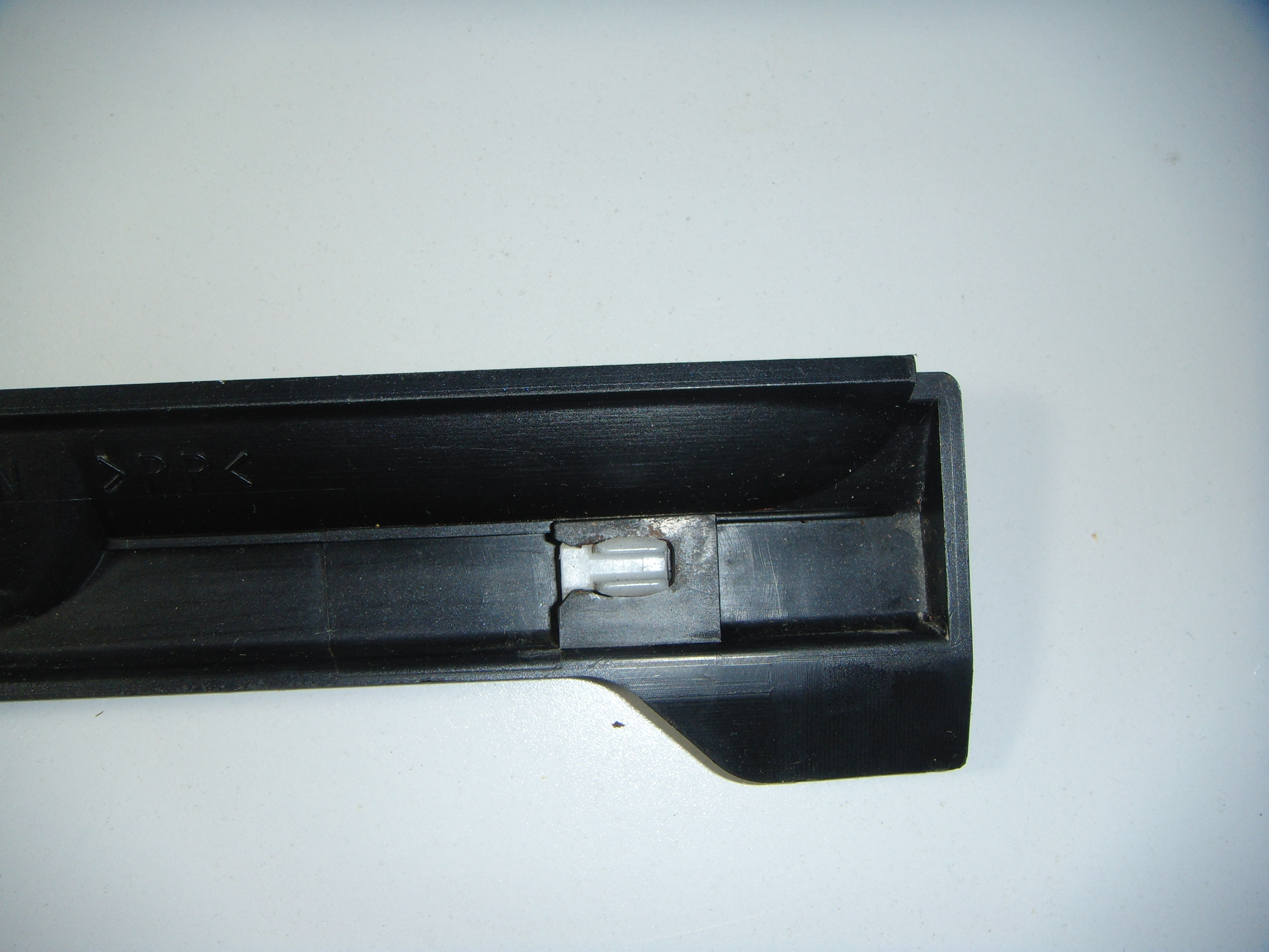

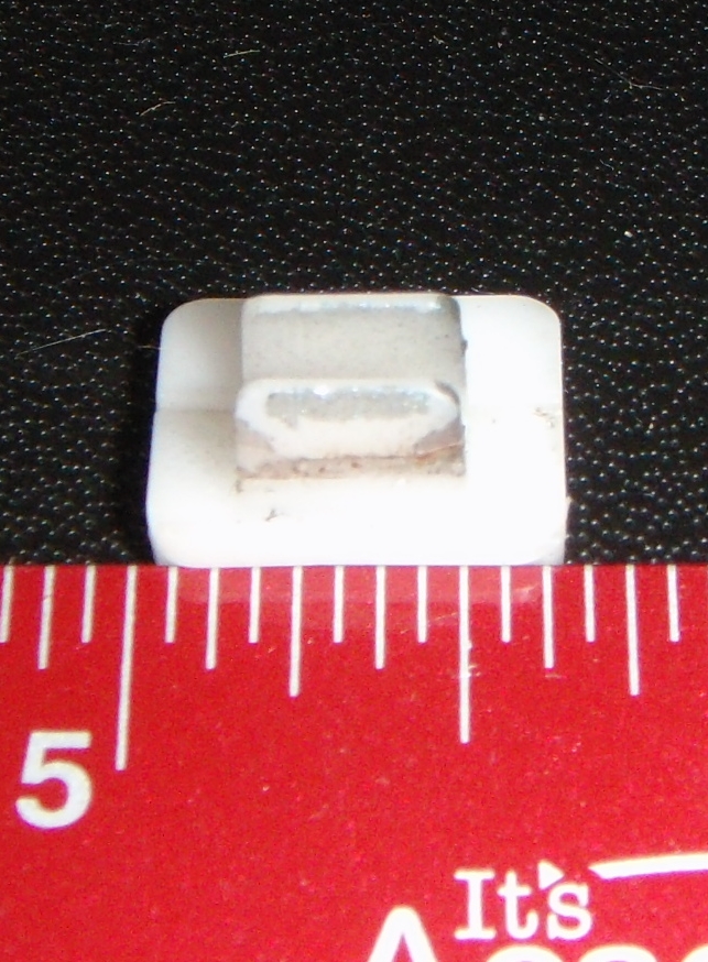

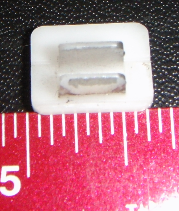

Pics attached are of the trim piece
and the clip.
I appreciate your help . . . Brian

Any chance you could post a pic of just the clip by itself? It's difficult to see it inside the trim piece, and the only part I'm coming close to is #62731fa000, which is a screw grommet (definitely not it).
If anything, I'd call your local subie dealer's parts department & ask for the clips for the trim piece, which is part #91242AE270BE. They *should* know what you're talking about. Heck, maybe the clips come with the trim piece?

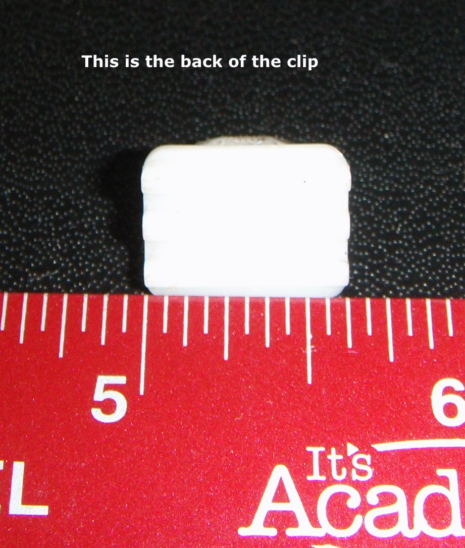

Also, some measurements:
From the back: 16mm long, 12mm wide, 11mm tall
Clip part on the front: 8mm long, 6mm wide
Yes, I thought the same thing about installing it.
Maybe I wasn't clicking it in right. I tried both
on the workbench and the car with the same results.
Even just the clip itself, not attached to the trim,
doesn't snap in properly.
I thought about giving the dealer a try too, but
thought I would ask here first.
Thanks again . . . Brian

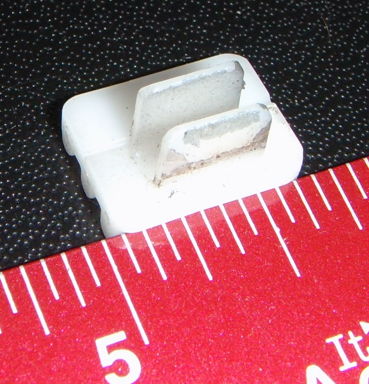

Re: Clips for Rear License Plate Trim
A couple more pics.
Could only do 3 in the previous post.
Well, I've checked honda, toyota, & nissan clip types as well (since they own each others' stocks & tend to share misc parts & the like)... and still nothing. This unfortunately might be a proprietary piece.
You did a lot of work on my behalf Guacamole
and I appreciate it.
I will get with my local parts guy and see if
there is anything available and one-way-or-
another, post the answer here.
I'm not hopeful though. If you couldn't find
it, I bet it doesn't exist as a separate item.
I aim to please!
Keep in mind though, I did broad searches through existing clips on first & third-party suppliers- the clip may still exist but maybe I'm not using the right keywords or something.
If all else fails, bolt that sucker back on!
Wow, believe it or not, just yesterday I started reassembling this entire bracket. I had removed the entire assembly, soaked it in an electrolysis tank for a day (to zap away the rust), cleaned and painted it too. It is definitely an interesting part! When disassembling it, I too broke one of the clips off that trim piece exactly like you. My research last week turned up absolutely nothing on the clips, but I did find the part numbers for the trim piece itself. They come prepainted and the price depends on the color (range was between $45 to $60). I would ASSUME the clips would be shipped with the trim piece, but I am not blowing cash on a guess. So, being the cheapo I am, I ended up hot gluing it back on at all 3 points. This is a very low use area, so I'm hoping it will last. If not, THEN I'll buy a new trim piece to see...
I am wishing now that I had knocked out the 4 studs like you did. While the electrolysis worked great on removing the rust, there was not much left of these studs. They are very short too. With some gentle manipulating I was able to get new nuts on all 4 studs, but there is not much material there holding them on. I expect them to be the 1st pieces to re-rust, even after painting...
