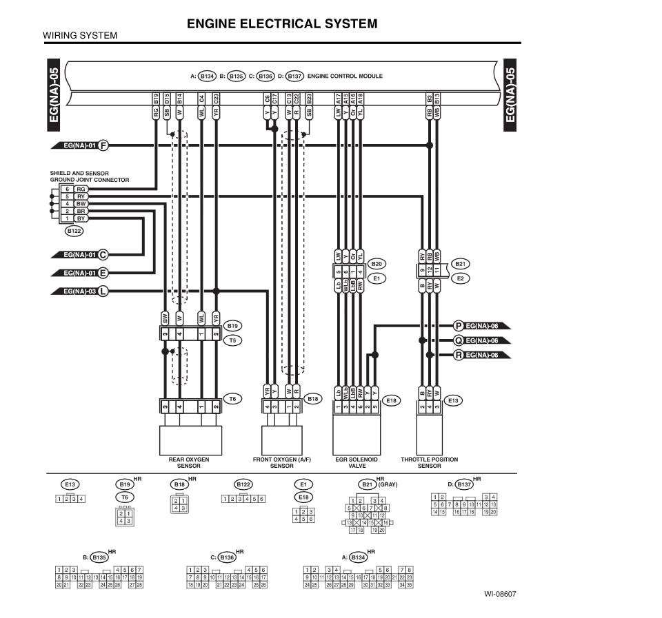

I have attached the wiring diagram for the oxygen sensors. Should help.

B18 on the diagram shows the correct color wires I have. Assuming the small bump on the top of all the connectors is the clip?

correct

Keep in mind the picture of the connector is facing the front where it would plug up, not the back where the wires go into the connector.

Now that I think about it, if I remember correctly, its the rear Ox sensor that you would need to look at for a P0420 code, not the front. I would also make sure there are no exhaust leaks or anything in the system.
