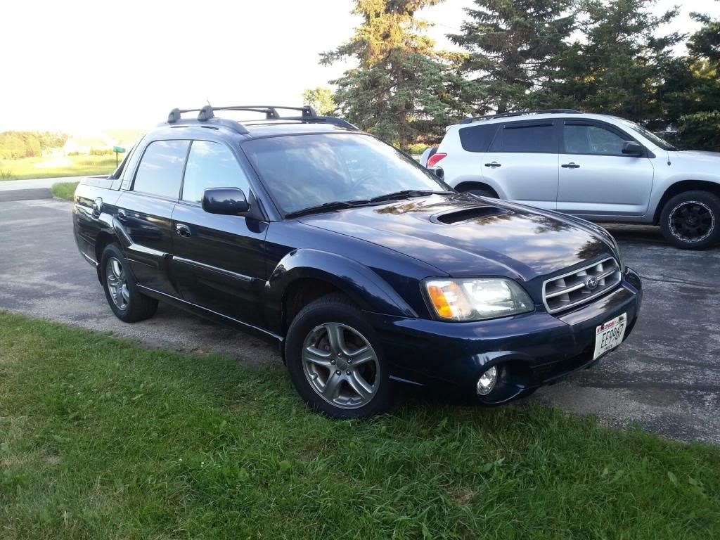

Mr.Chow
Posts: 8
Joined: Mon Aug 05, 2013 6:13 am
Re: NEW TO THE BAJA, A FEW QUICK QUESTIONS
Post by Mr.Chow »
WOW!!! you managed to get the same color as me, what a coincidence. 8) I'm hoping to get a response from a member on nasioc on the dp thing today, I'll let you all know. I NEED MOAR POWA!!! <----[ I'm not that guy, but it's an honest statement. I"m probably going to do a stealth setup using the factory exhaust and a 3'' cutout.
