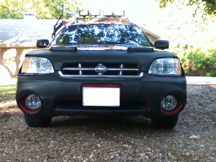

Re: Cloudy Headlight Lenses
That sounds similar to the 3m kit. I know new headlights run about $75, but I figure they're going to end up yellowing too. So I got the weathertech lampguard film. It ran about $50 but came with protection for the fog lights too. This pic was just taken recently and I did the restoration mid-summer. They're sooo clear!
