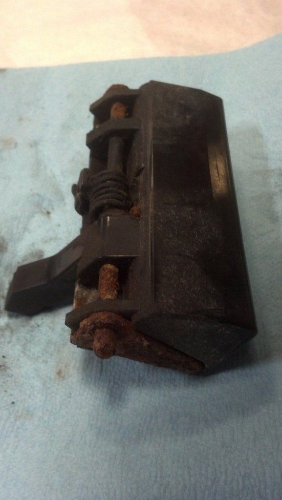

This problem seems to be happening to quite a few Bajas now (including myself). The handle assembly pivot (not the latch assembly) needs to be cleaned & lubed every so often to keep it acting right. I took mine apart, it worked for about a year, but is starting to stick again...

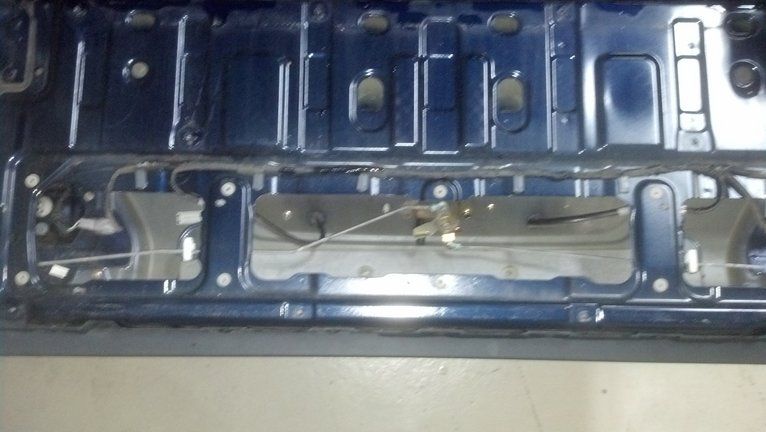

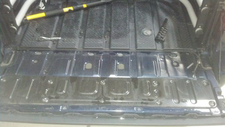

I have also had this problem for a few years now. I have just lived with it and it was almost habit to manually return the latch handle after opening the tailgate. Today I decided to fix it. As described I removed the tailgate bedliner plastic (torx screws) and the metal plate behind it (10 phillips screws).
I disconnected the pushrods from the center bellcrank thing and the removed the bellcrank thingy by removing the two 10mm nuts. Then the plastic panel above the lic. plate lights comes off with 3 8mm nuts and a phillips screw. Once that is out the actual latch handle can be removed by releasing the plastic clip from the back side.

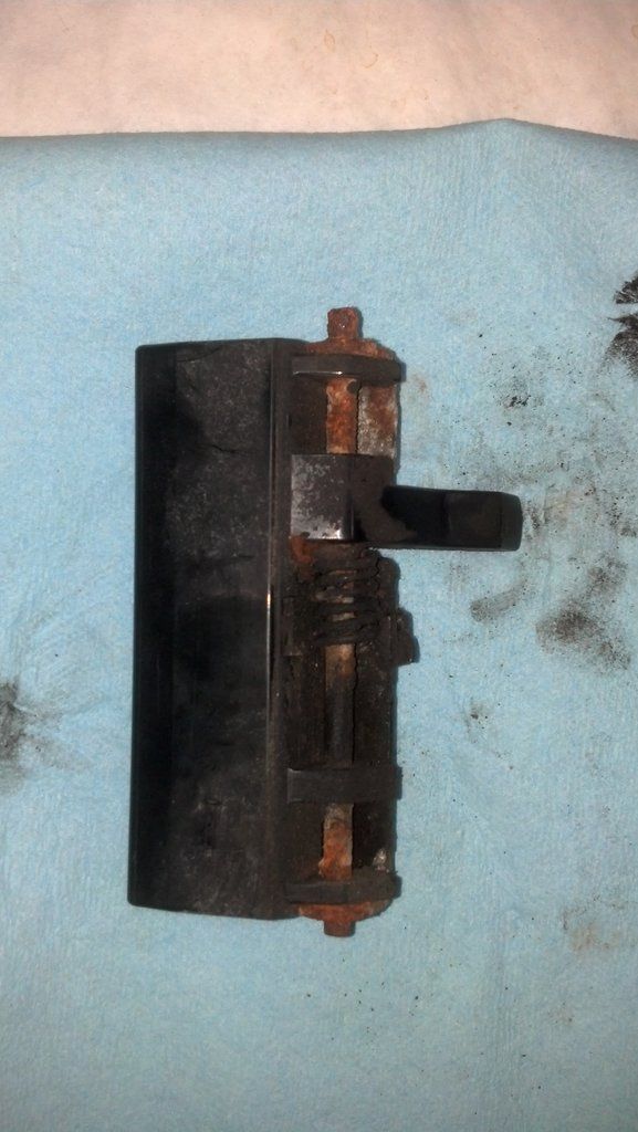

This handle was my problem. The hinge pin was highly corroded. It was so rusted that it had actually expanded and was causing a lot of resistance on the handle, so much that the return spring could not return the latch to the closed position.
No amount of lube could really help so I cleaned it with brake clean, got a hammer and a drift and drove the pin out of the assembly. Once out I took the hinge pin to the bench grinder with wire wheel and cleaned it and the metal part of handle. It was then reassembled with anti-sieze and grease, and re-installed.
Wow, what a difference. Not only does the latch open like it was brand new, it also returns to the closed position on it's own. The entire process should take around 30 min.

You lost me when you said to disconnect the rods from center bellcrank thing. How is this done? It looks like there are some small plastic ends to the rods where it connects & I don't want to damage them.
The plastic panel above the taillights, does that hold in the black handle? Is it directly below the bellcrank in the center?
How does handle hold itself in, does it connect to anything else?
I got as far as removing both panels from inside of tailgate exposing the bellcrank and pushrods. I lubed all this, but the handle is still sticking. THis is where i am not sure how to get handle out.
