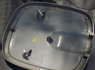

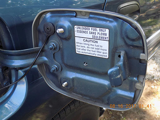

If the cover isn't off yet, it's held on by the two black plastic "screws" and two plasic lips moulded into the right side that fit over the metal fuel door. BE CAREFUL NOT TO BREAK THESE

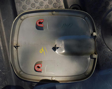

Cut a notch on the right side of the "screw" holes on the cover, just wide enough to shove the new bolt between them without falling out.
Step 2
Shove the bolts between the freshly cut openings with the threads facing you.

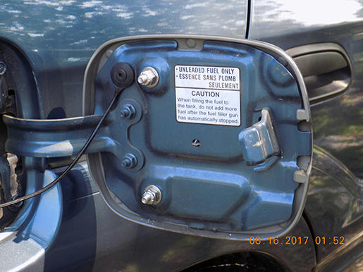

Reattach the cover to the fuel door. Remember to attach the lips at the right first, then put the bolts through.
Step 4
Now comes the fun part. Here you'll need to put the nuts on the bolts. This can be done several ways. I did it by using a pair of vise grips and simultaneously pulling and twisting the nuts on so the bolt wouldn't spin. Make sure they're tight enough to not wiggle, but not so tight the plastic breaks. You can also glue the bolts to the cover to make it easier, but I have no idea how well this will hold when tightening.
And you're all done!
