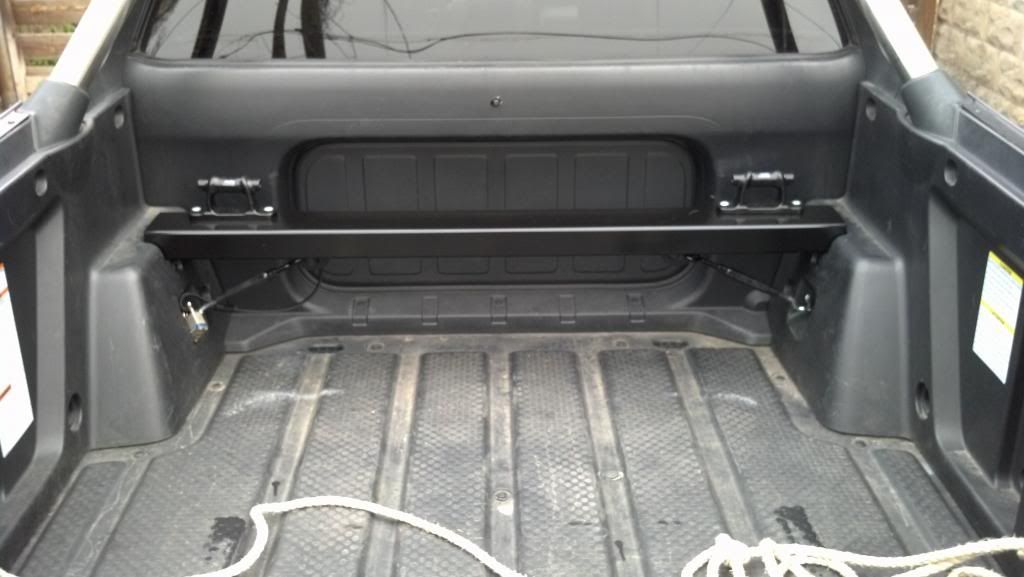

I had seen the 2x4 method, but did not like the security of it so I decided to modify it a bit.
Supplies:

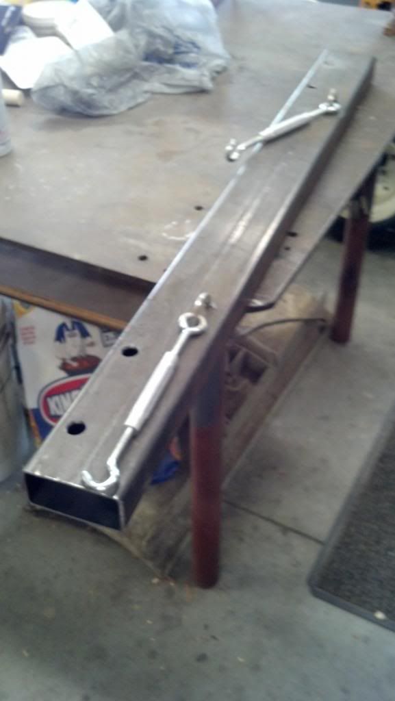

45.25" Square tube steel (2x4x1/8)
2 - 10" Turnbuckles
4 - 1/4x1" camber bolts
8 - 1/4" nuts
2 - Bike fork mounts (I used Rocky Mounts Clutch's)
~12" of wench line with loop
Paint and Primer

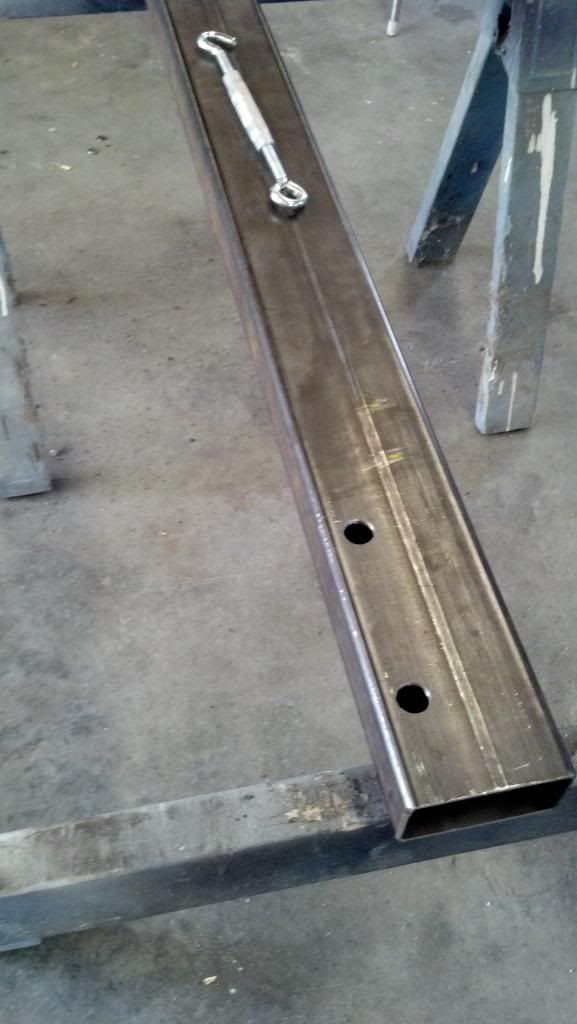

Started with about 6' of steel, so had to cut some off.
Measured and marked the location for the forkmounts. Then drilled 1/4" holes all the way through.
The bottom holes were then drilled out larger to allow for a socket to tighten the bolts and keep them out of sight.

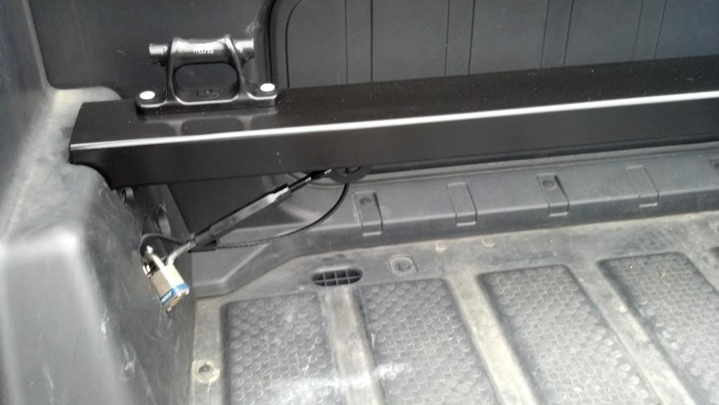

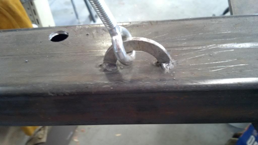

The turnbuckles were attached to the bar by cutting out 1/8" steel loops and welding them to the bar.

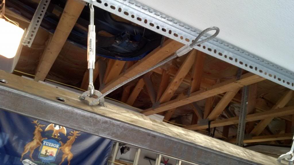

A hole was drilled and the wench line was run out to serve as a locking point.
Finally the whole structure was primed and painted, and the fork mounts installed.

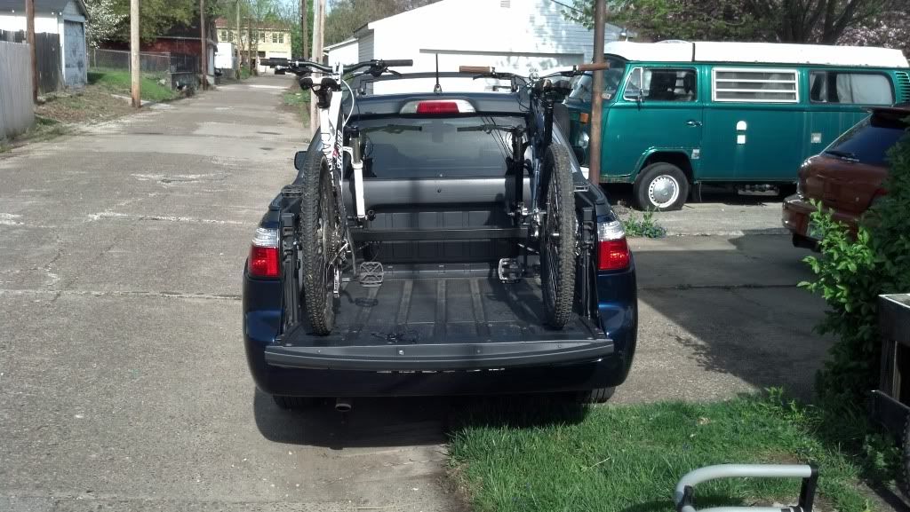

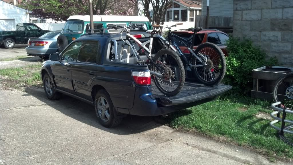

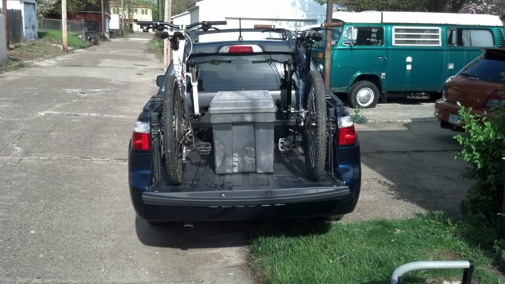

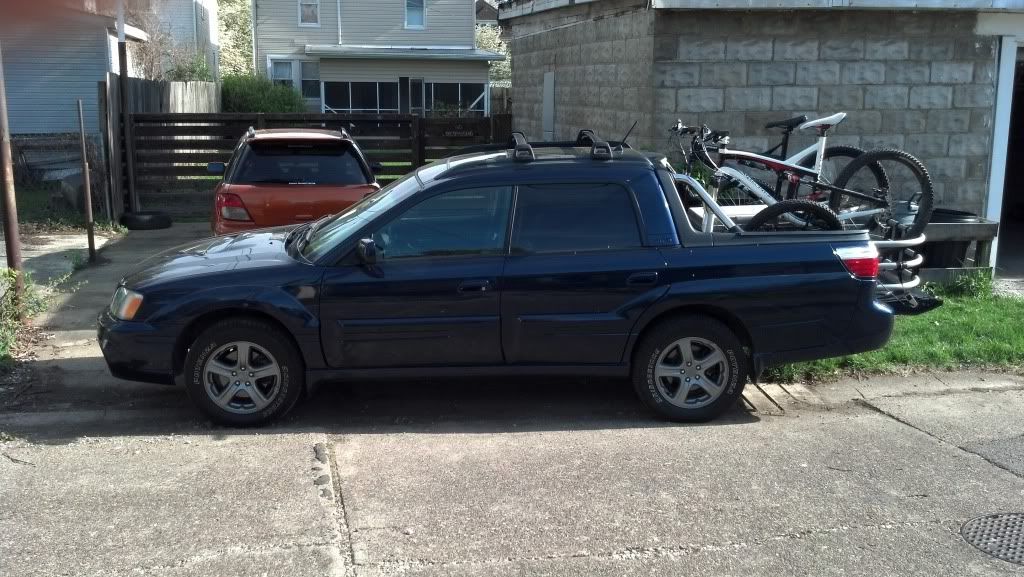

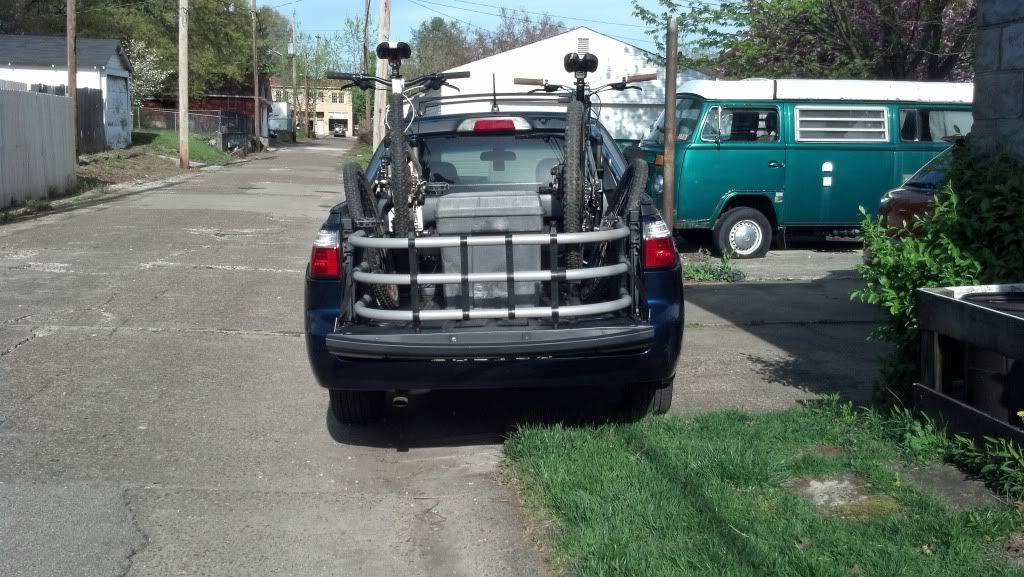

Installed pic's:
Will post pic's with bikes soon.
