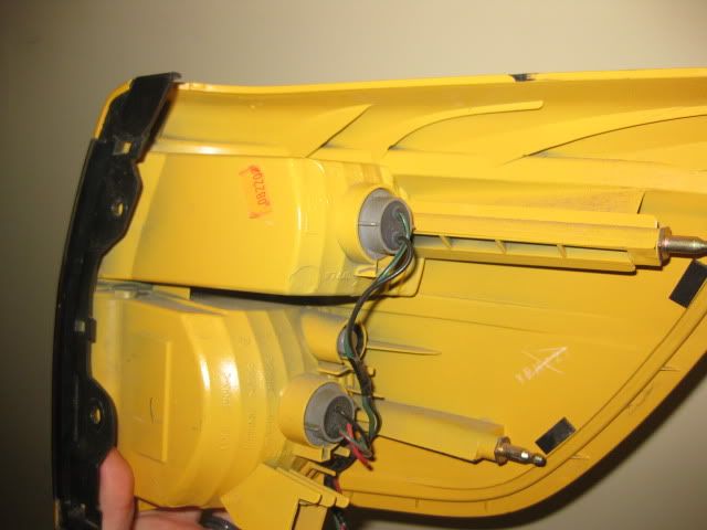

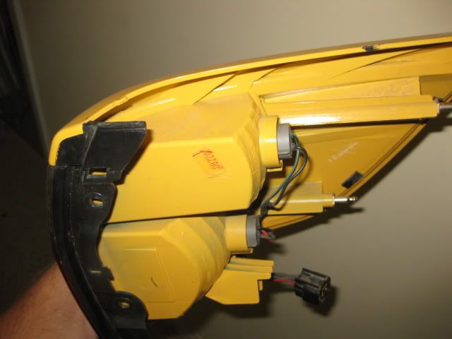

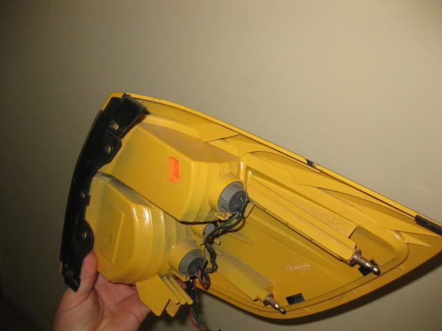

well I can tell you the light slides straight back, so hopefully u shouldnt have to remove the ARE, but thats just hoping since Ive never owned a cap. Water sometimes gets into light housings because there is something clogging the path the water is supposed to flow, maybe u have some junk around the housing? I can show u the back of the housing, theres not many places water would get in. Lemmme go get a pic.

its really sealed off, maybe one of ur lights isnt sitting in the correct position and its letting water in?
i would definetly try drying it out and then just making sure its installed correctly with the bulbs all nice and snug, before buying a new one!
