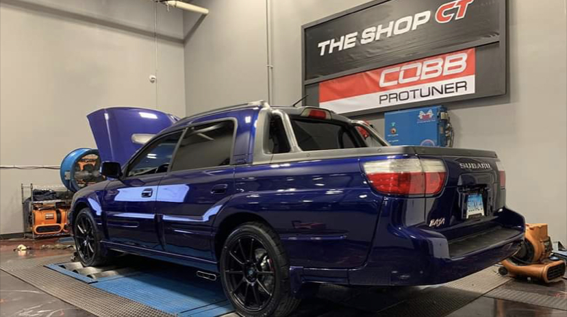

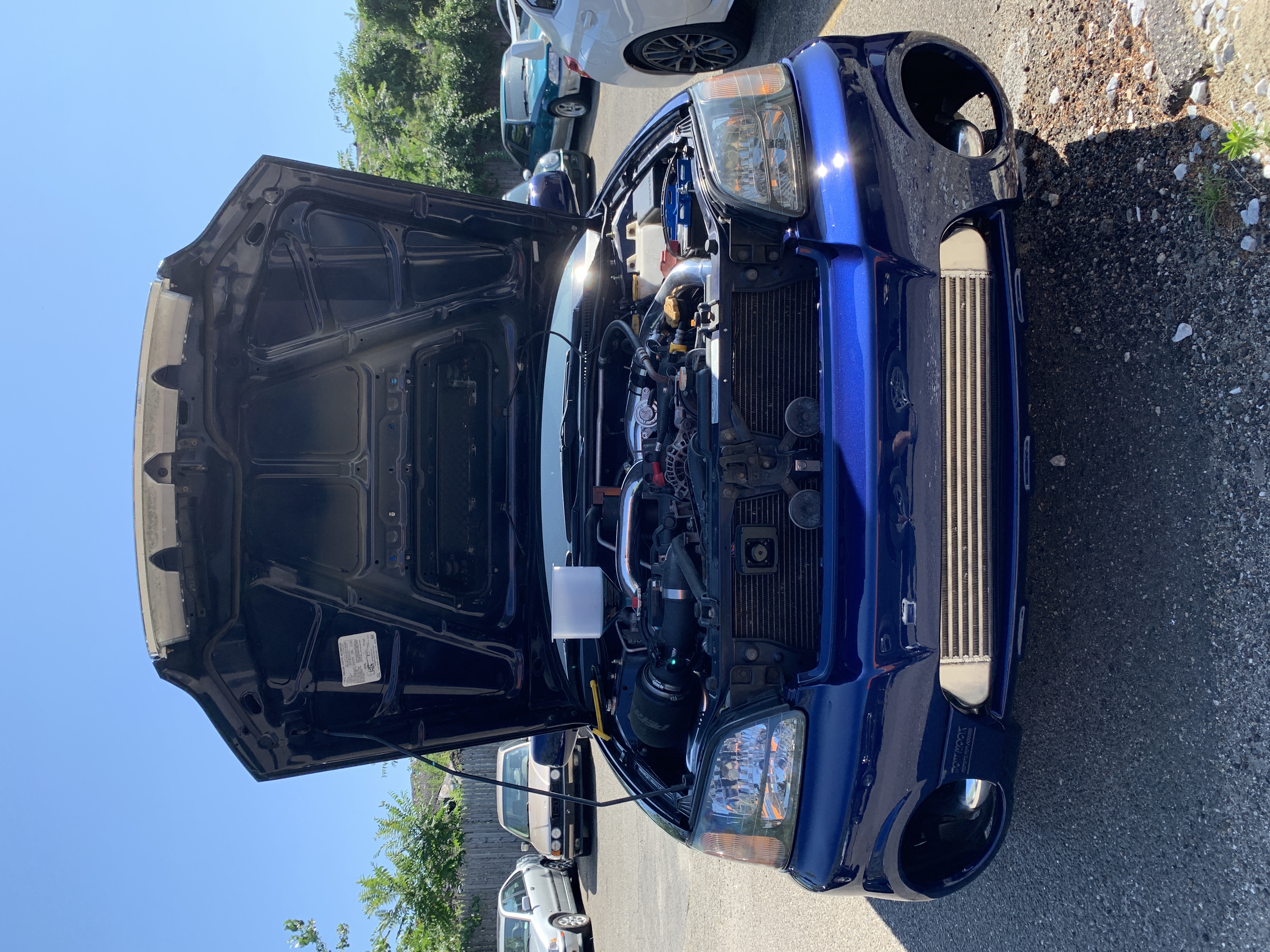

PizzaWrench, I own a 2005 Subaru Baja Turbo with a 4EAT transmission. The car has a built engine to handle 600HP and several additional bolt on performance parts.
The car was tuned via Rom Raider and I am currently running a 16G XT 8CM turbo. The car made 290WHP and 347TQ.
I will be sending the transmission to ITP for an upgrade over the winter time and I plan on running a larger turbo. However, I would really like to run the Cobb Access port and their flex fuel kit to tune the car!
I just wanted to confirm that if I spend the money in purchasing a 2004 Forester XT Auto ECU that it will work with my car… Thank you!
