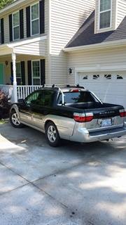

Howdy! i just bought this little truck a month ago. I love the damn thing. it needs a rear diff, i think. Im not a mechanic, but I can do some things. i have questions though:
1.Which Subies out there are good donor cars?
2.How can you tell if a rear diff is the one are there markings?
3.I think the rear diff on my car is 4.11 gear, if Im wrong, please correct me.
4.How hard is this job? is there a video somewhere?
2003 Baja Manual NA. 240k. Transmission replaced and is at 86k. front axles replaced. timing replaced. Head gaskets leak oil but do not mix or run hot. AC does not work(holds pressure), sunroof does not work. Any help appreciated, this is my first Subaru.[img][img]
