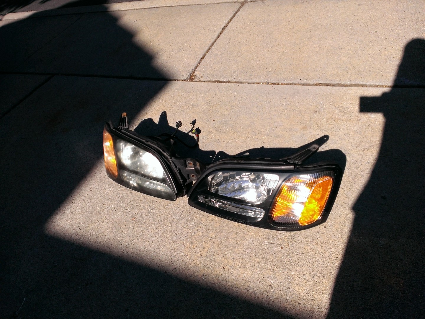

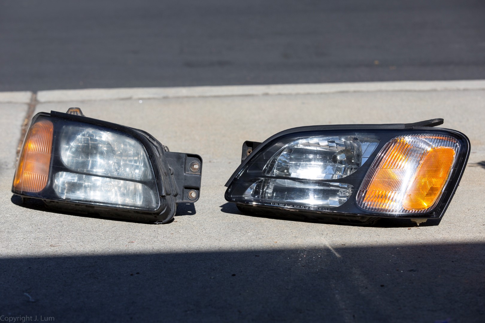

I have a couple before and after photos of the Meguires kit attached. My friend had some leftover, so didn't pay for it (well, not with money).
- WP_20150725_003.jpg (459.68 KiB) Viewed 83657 times
- 3P2A9773.jpg (349.99 KiB) Viewed 83657 times
