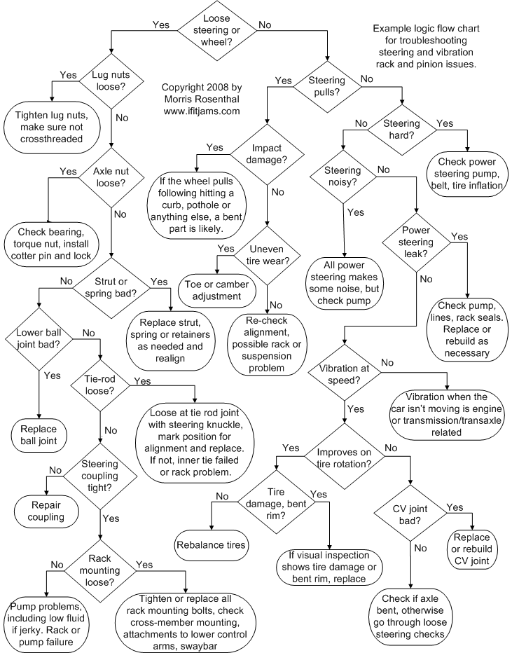

Hey guys and gals. My issue has to do with steering. If I turn my wheel all the way to the left (full lock or near that) and then straighten out, my car begins to forcibly drift to the left and the wheel does not want to be centered. Then if I turn right (full lock or near that), it will drift right and the wheel will not want to be centered. Essentially what I am saying is whichever way I turn, the car then wants to go that way until I turn another direction. I SUSPECT it may be the power steering rack. What do you think? I would appreciate others opinions before I spend money and time on that. Thanks guys!
Mike
Re: What's wrong with my Baja!?
Found this chart, maybe this'll help?
