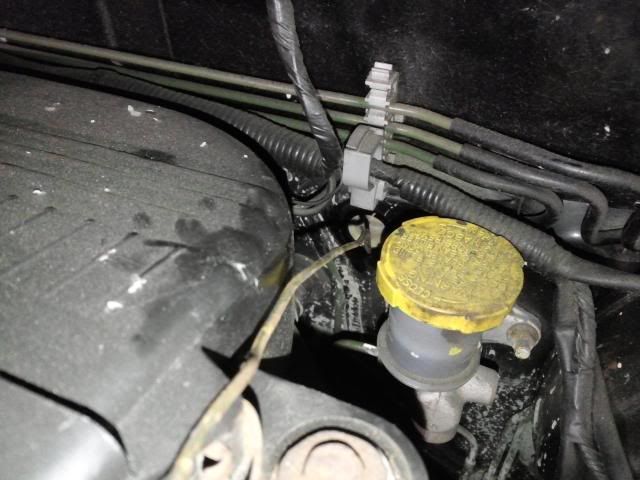

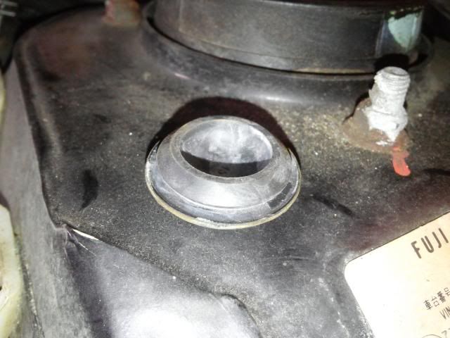

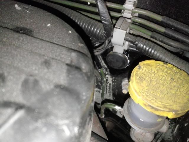

Remove this round black plug. Be careful of your clutch fluid reservoir.
Looks like this...
Break thru with a screwdriver at a downward angle and to the drivers side, Push some....it's ok. Coat hanger used for photo purposes.

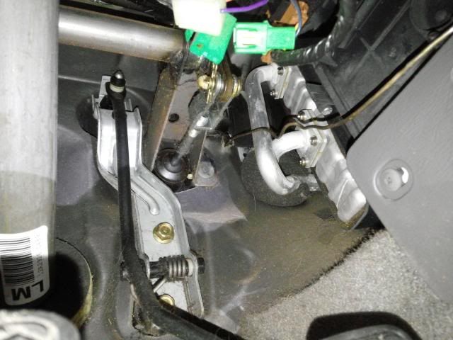

Comes out here...That's the gas pedal.

Would be better if you just ran it through the grommet that you removed...just put a little slit in it with a knife..keep it from rubbing on the metal around the edge of the hole..Other than that A++++
