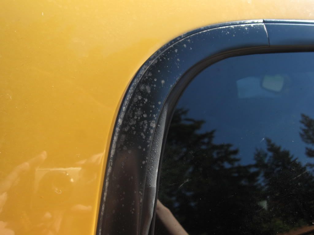

Anybody have any suggestions on cleaning the "spots" (that look like mildew or something) off of the black mouldings around the windows??? I have tried back to black and clorox clean up. If anybody knows how to restore these please let me know.

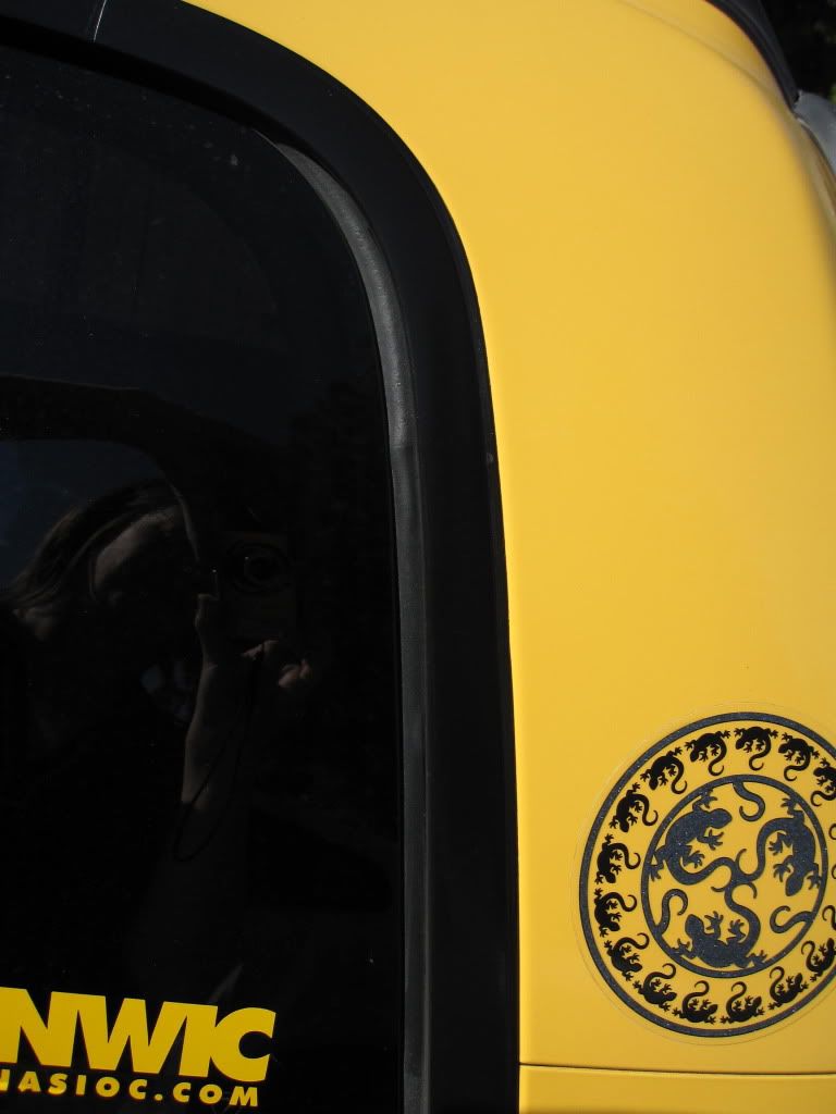

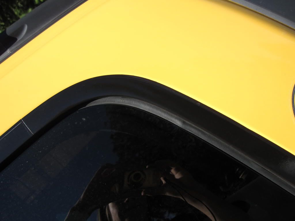

But here are the results that I had with 'Rust-Oleum' Paint for Plastic (Black). Plus, it's just fun spray painting your car.
I'm amazed that it doesn't even look spray painted. This item sprays very evenly.

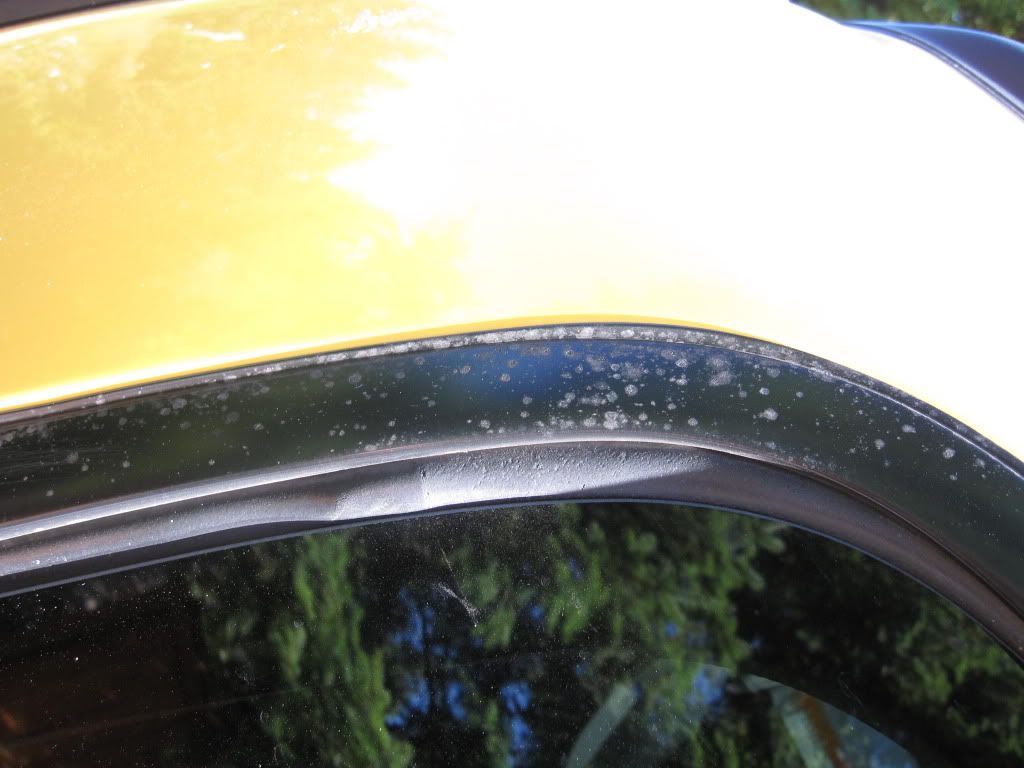

One side I didn't do yet:
This one corner section I completed:

Yeah, I would try that first as well. I tried it and it didn't work on mine so I went with the painting. Since I scrubbed the heck out of it with the Back to Black, it took about the same amount of energy and work on my side. Cleaning, taping, and spraying paint is pretty easy, just timing consuming. I just wish Back to Black worked on my side.
I think I'm going to finish painting today when I get home. I'm going to tape it all off and spray it down!![666 [smilie=666.gif]](./images/smilies/666.gif)
*edit* I just finished the other corner section today. No more bad looking molding around the windows!! I'll have to paint the rest of the sections to match but it doesn't look bad at all. I just wanted to get rid of that horrible spotting.![disgust [smilie=disgust.gif]](./images/smilies/disgust.gif)

What the problem is is fallout. Schmegma in the atmosphere like acid rain, UVs, etc. conspires to break down the rubber. It's just what you see in older weatherstripping, like around windshields and the like and it is irreversible, just like wrinkles on a pretty face. The paint is a nice, if not permanent, solution. Should last quite some time tho'.

I kind of wondered if it was something like that. Environmental damage, etc. I am curious to see how long this paint will last. It's a spray on plastic coating so it should last a while...hopefully.njswampbuggy wrote:emsanon, that looks outstanding. Nice work the the can...man. That is on my to do list.
