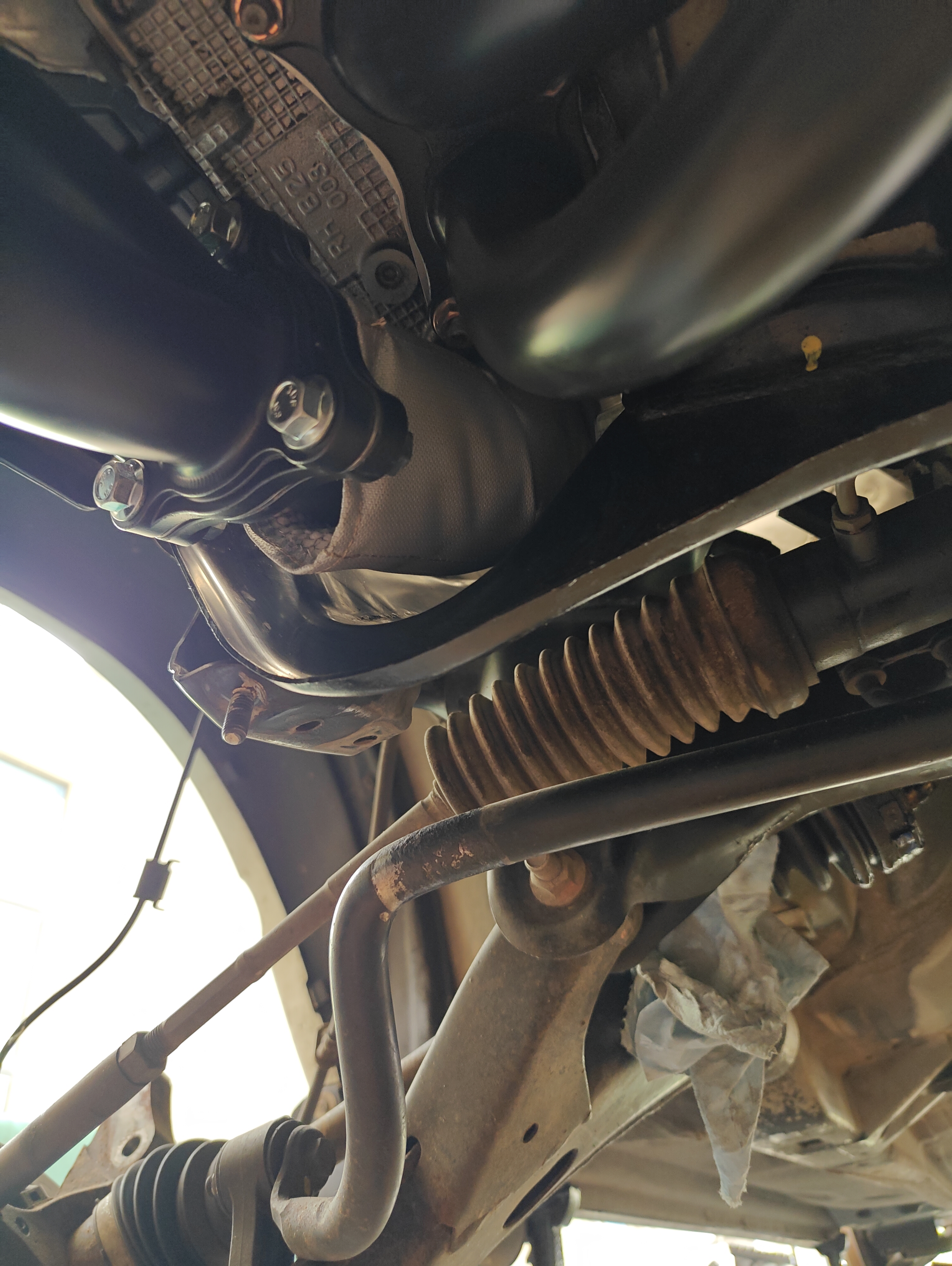

Got the headers and oil pan done. Still waiting on powder coating...
- IMG20240322105223.jpg (4.17 MiB) Viewed 189613 times
Turbo, downpipe, up pipe and blankets are in!
- bee533b7-af1a-4690-9ff5-9d57e01d3d04.jpg (6.55 MiB) Viewed 189398 times
- IMG20240414105310.jpg (5.18 MiB) Viewed 189398 times
- IMG20240414093321.jpg (5.45 MiB) Viewed 189398 times
