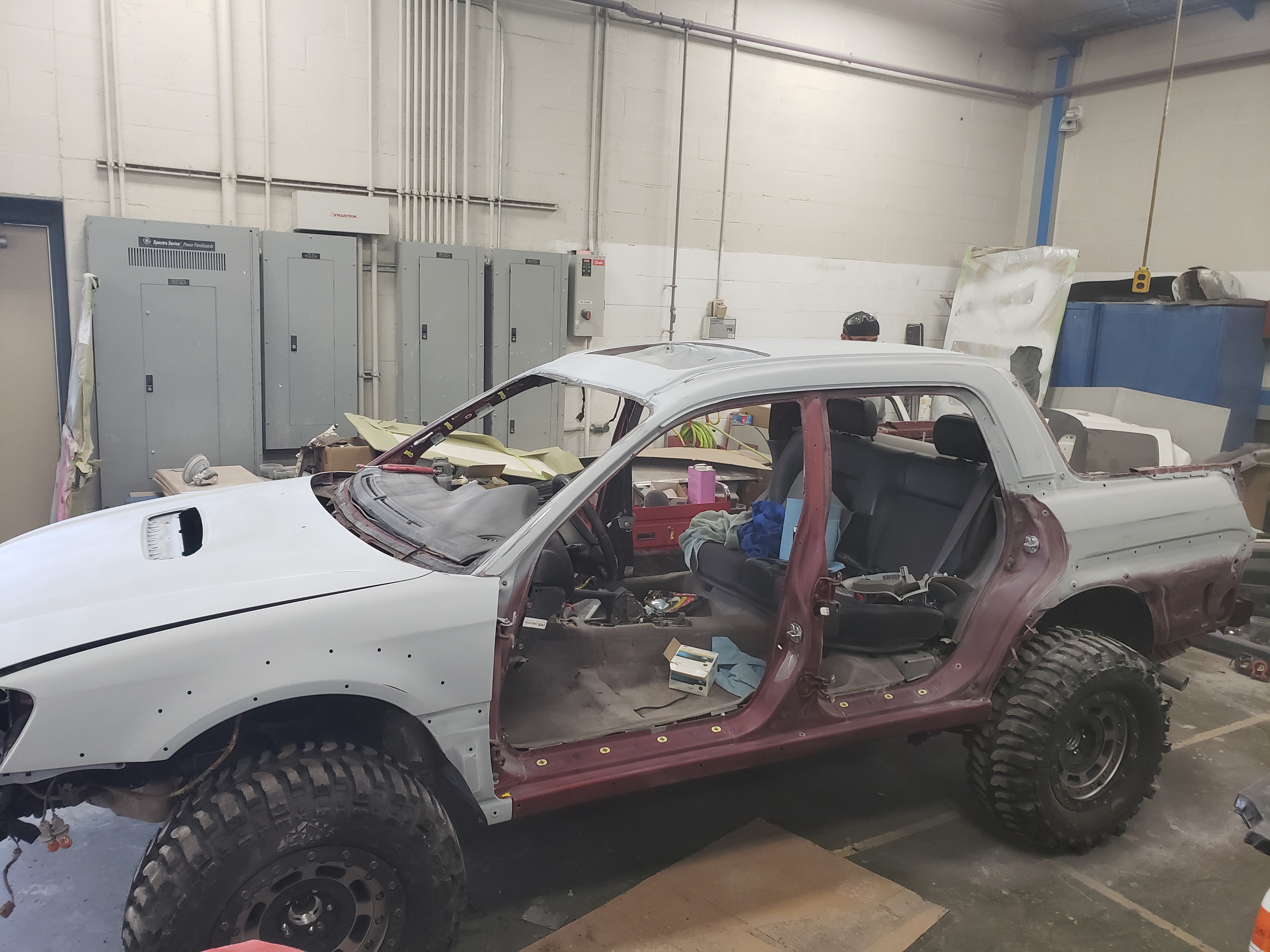

It has been quite some time and things have been absolute madness. Teaching High School, teaching College, Doing Ironwork, and taking college classes as well. Not much for the freetime. We have made some very good progress and we are one week away from the Piston Powered Autorama that the Baja will be unveiled at.
This was on Friday just passed, primed and ready to go into paint. We are using a Mazda colour that would naturally be a pearl coat and be a PITA. When it is all said and done though... she gonna be sharp.

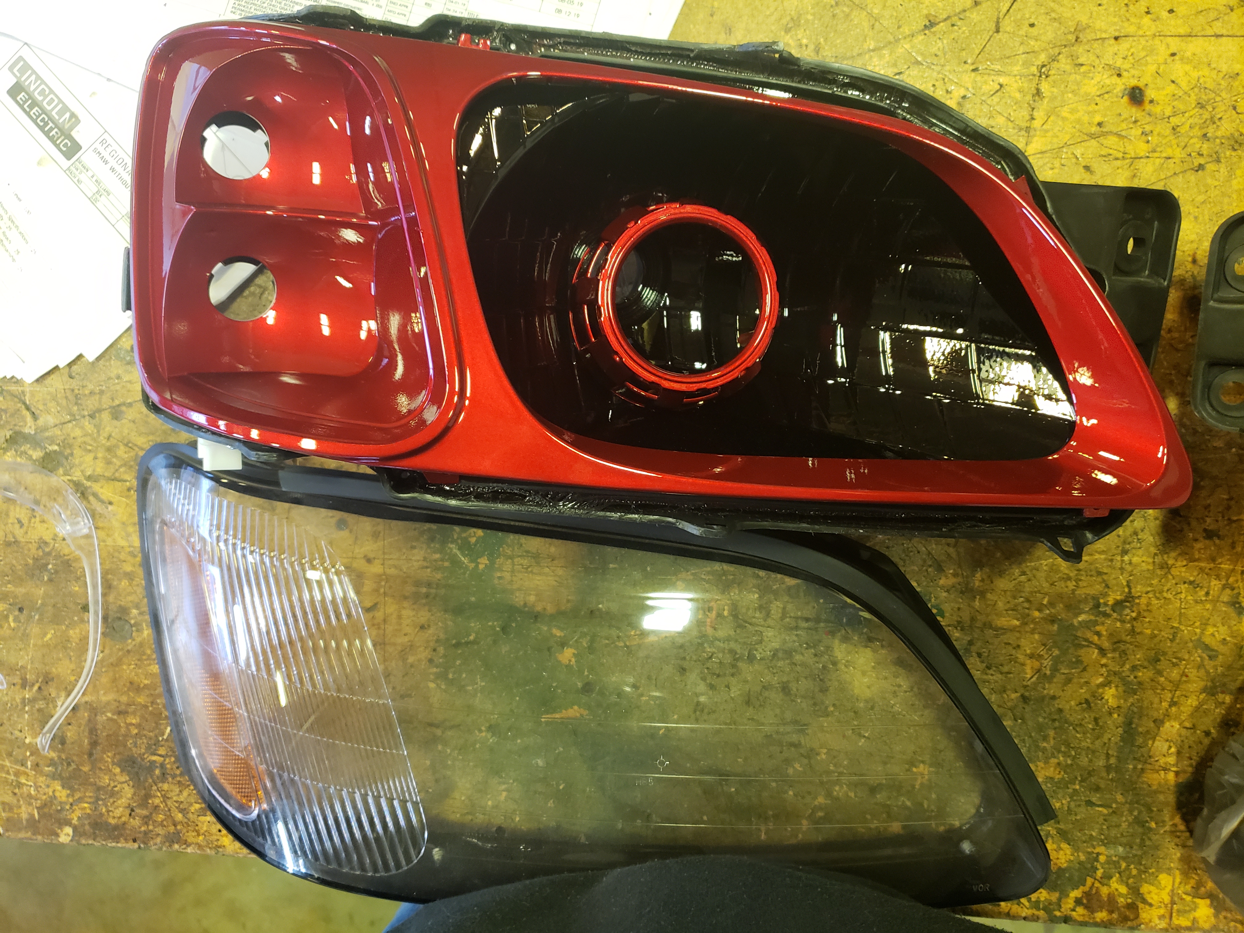

Everyone needs headlights ... right? These were brand new, baked, tore apart, painted, and put back together to be baked. They do have halos and will have to be wired in... much fun.

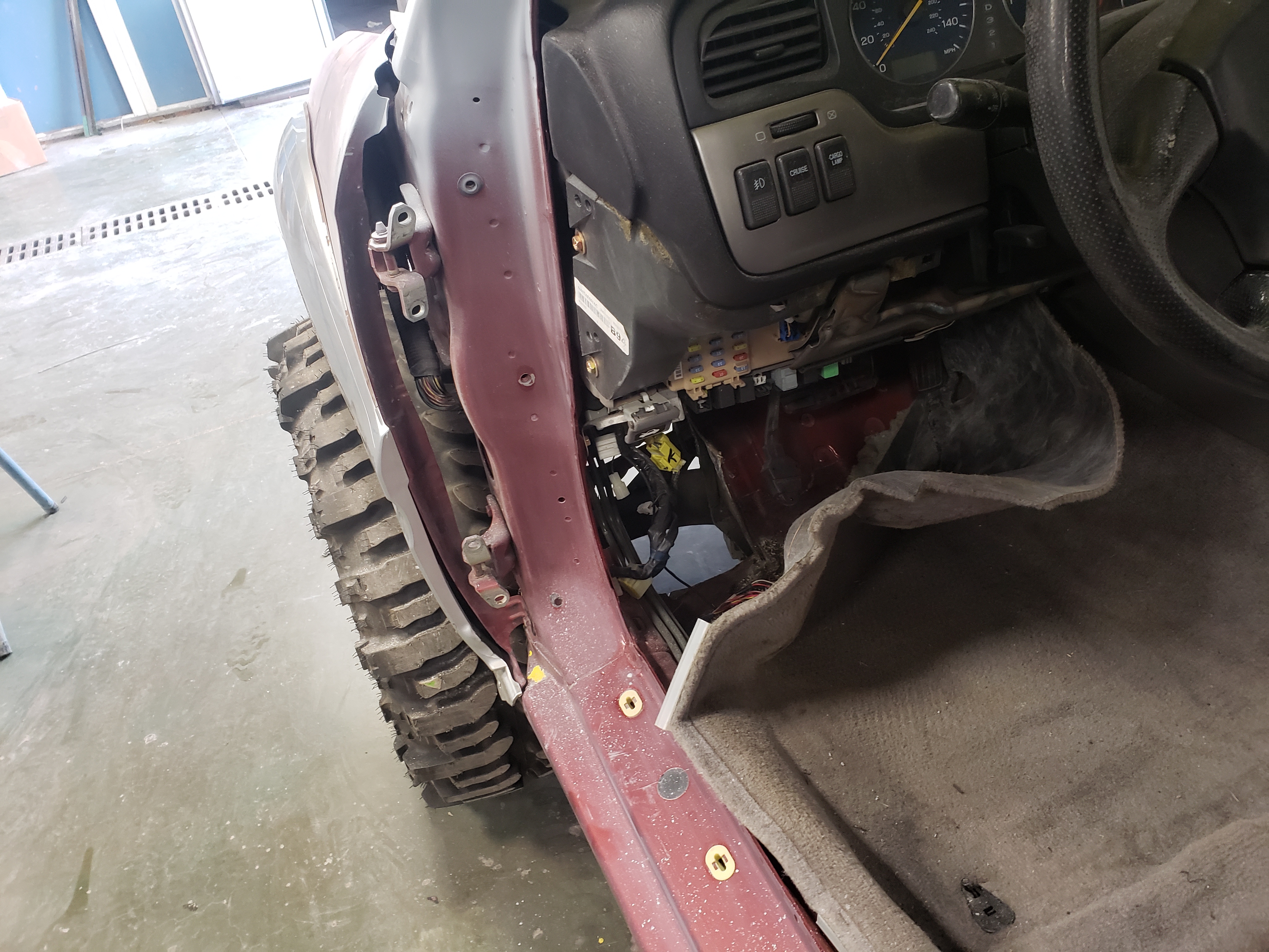

I did want to show that we had to carve a fairly large chunk of floorpan out to make these tires work proper... worth it IMO.

I love your wheel well solution, after almost good enough shaping I broke out the plasma and made space, no regrets. If I missed it in this thread my apologies, but if your Baja is an auto it is absolutely worth installing an IPT high stall Torque Converter. The bigger the tires the more transformative it is in performance. Turning up the boost helps recoup lost power from bigger tires, but even with a high HP build you still have to "crawl out of the hole". The high stall TC lets the engine get into the power band before loading it up and WOW what a difference.
