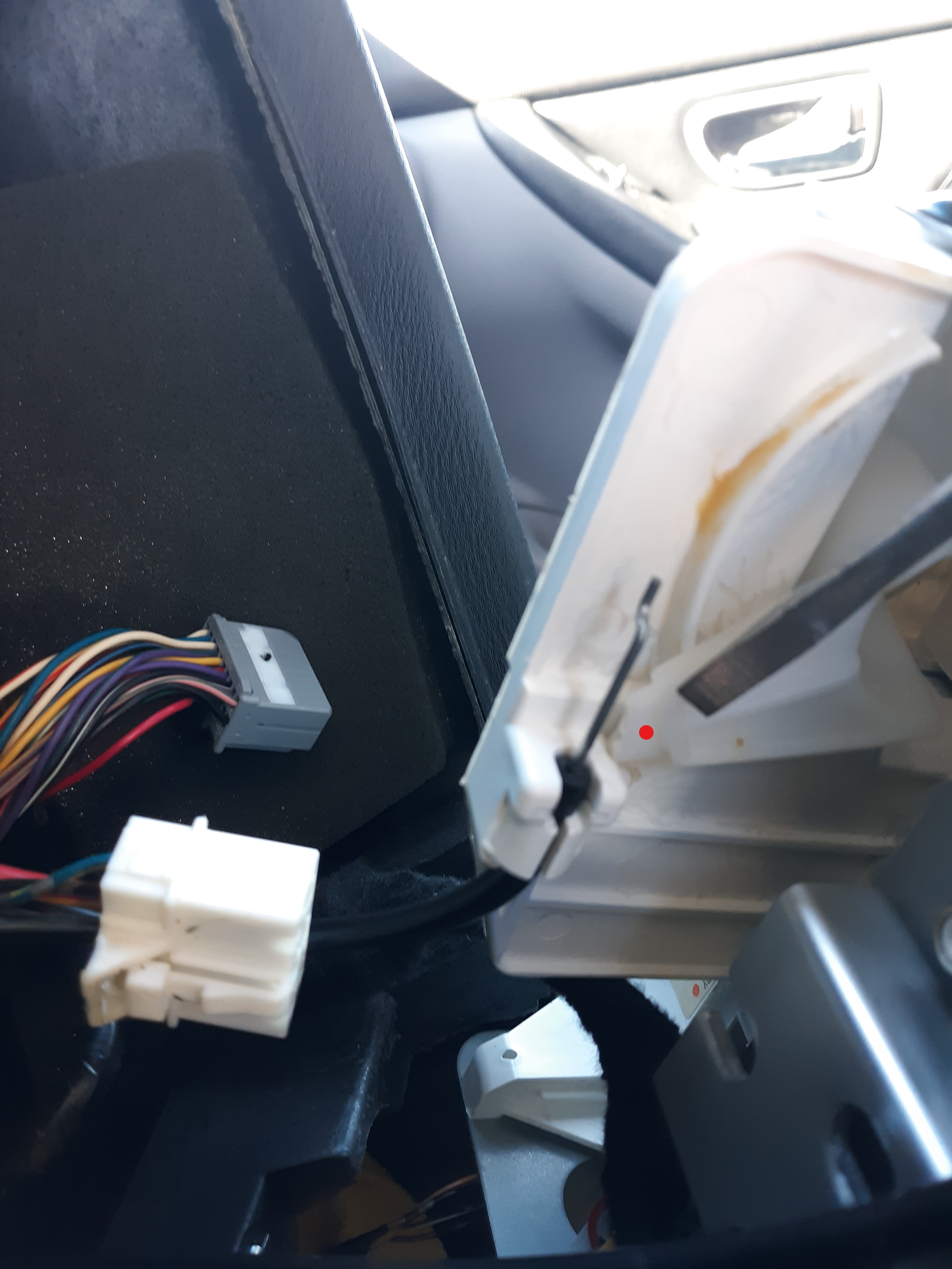

Hey tsmart, mine broke almost exactly where yours did. I drilled a new hole at the red dot (see attached pic). Your local pick and pull probably has a Legacy you can snag one from as well:

Will that cable back out of molded stop or must i disconnect behind glove box? Cantget a drill on it till the whole thing is clear out. I just may have a shot at a new hole.

Its fixed. Drilled the hole, removed cable below glove to get some slack.. Though I am certain I have full air and full heat, the dial knob wont go all the way on to the stop on the AC side. Its close. I think the reason is the new hole changed the linkage point a bit. To the right, (heat) it goes all the way..but Im happy. Thanks for your help. Saved a bunch. Happy wife.😁

Yeah you are probably sacrificing some of the min/max temp control due to the shorter "throw" of the control arm, but its free and it works.
