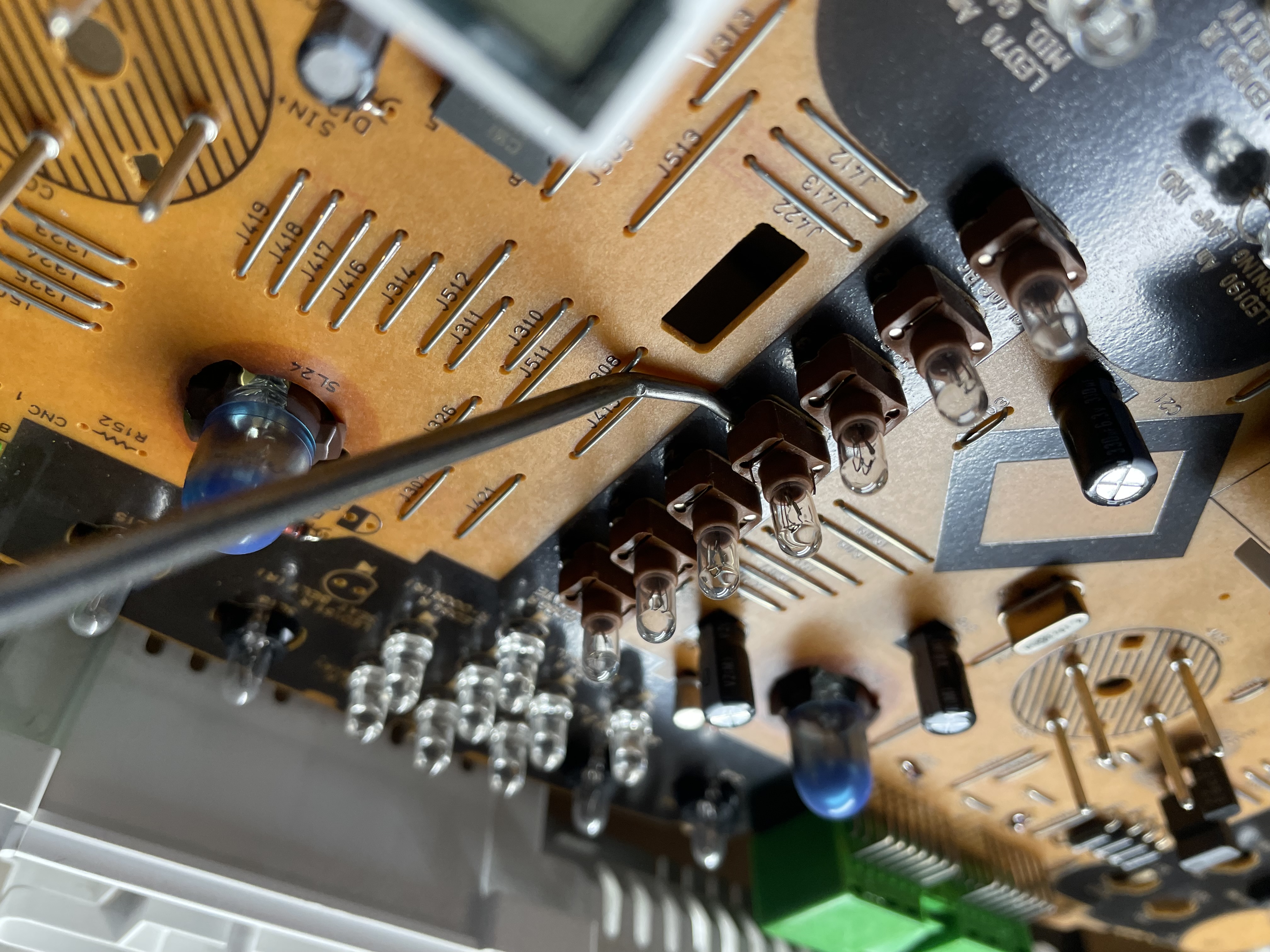

Semi-related, the light for the “D” in the PRND321 column of the cluster went out when I replaced a few other bulbs some time ago. I used the first post here as a guide to disassemble and a couple of YouTube videos, like:
https://m.youtube.com/watch?v=WXkSBzGQTjg
Most bulbs can be changed simply by getting the cluster out. Those lighting up the PRND321 selections cannot. I found this thread to help me disassemble the cluster to get to those lights: https://www.subaruoutback.org/threads/g ... ly.173626/

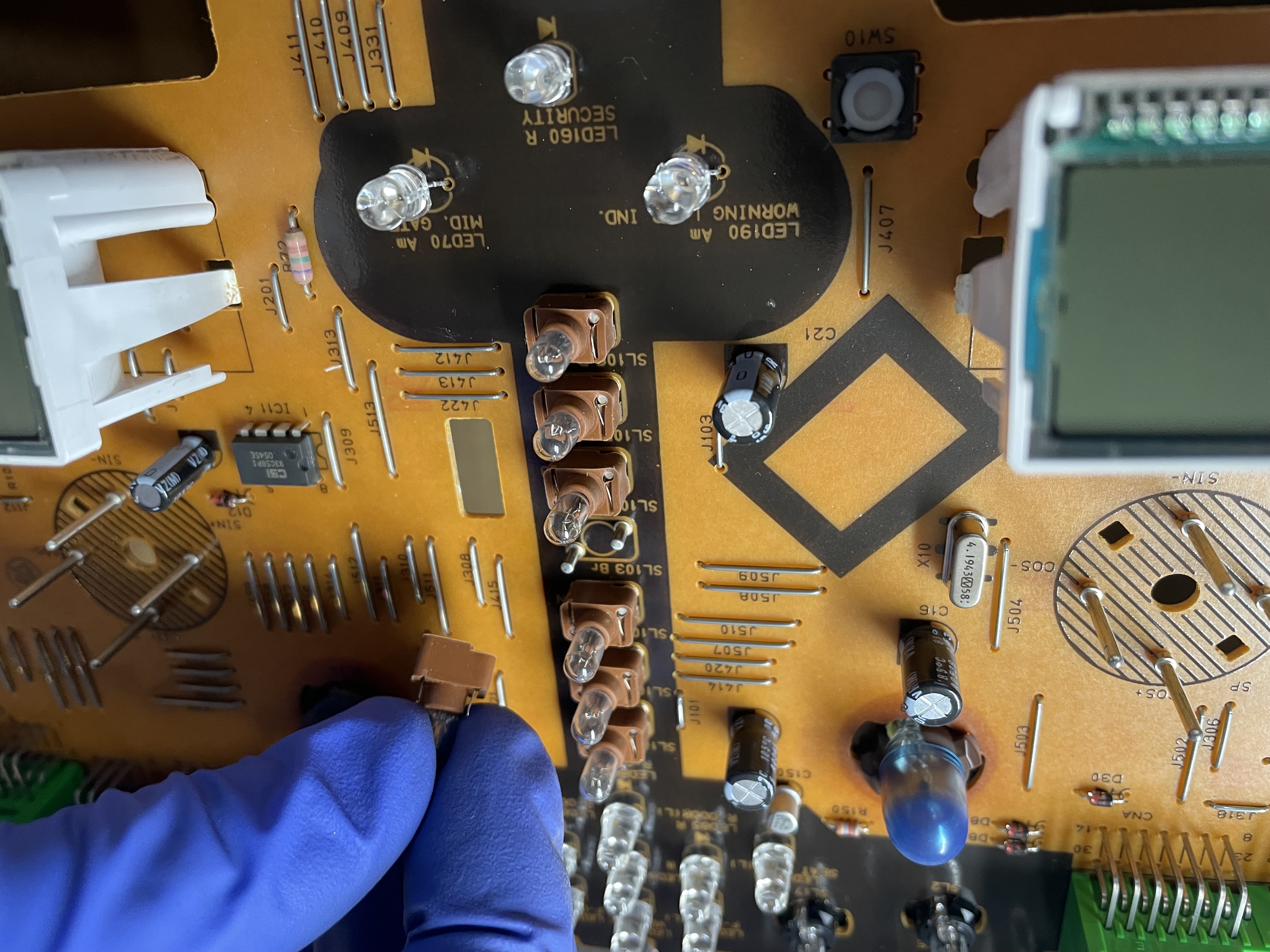

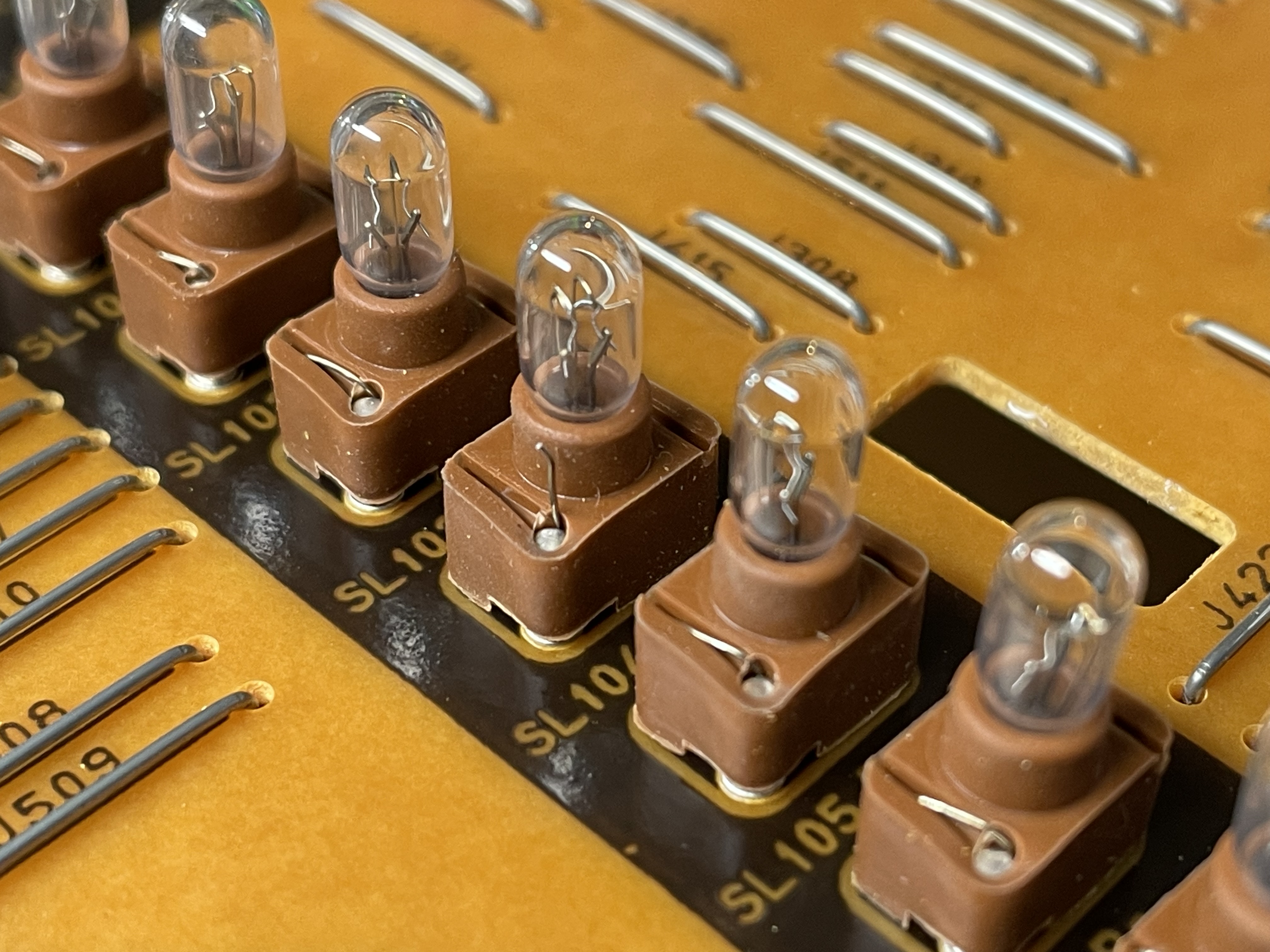

I didn’t think the instructions were super clear regarding the bulb and socket removal. As “straightforward” as it should have been, I think a few more pics could have helped. Although I show the thin wire vertical, it does not need to be moved.
The socket can be pried up and off the board. I used a pick tool on either side to walk it up and off evenly. The socket base is rubbery so it squeezes tightly onto the posts from the board.
The socket is removed and the bulb & socket can be replaced.
I thought I had some of these handy and did not, so I ended up swapping the bulb and socket from “3” to “D”. At least I know how this thing comes apart now!
