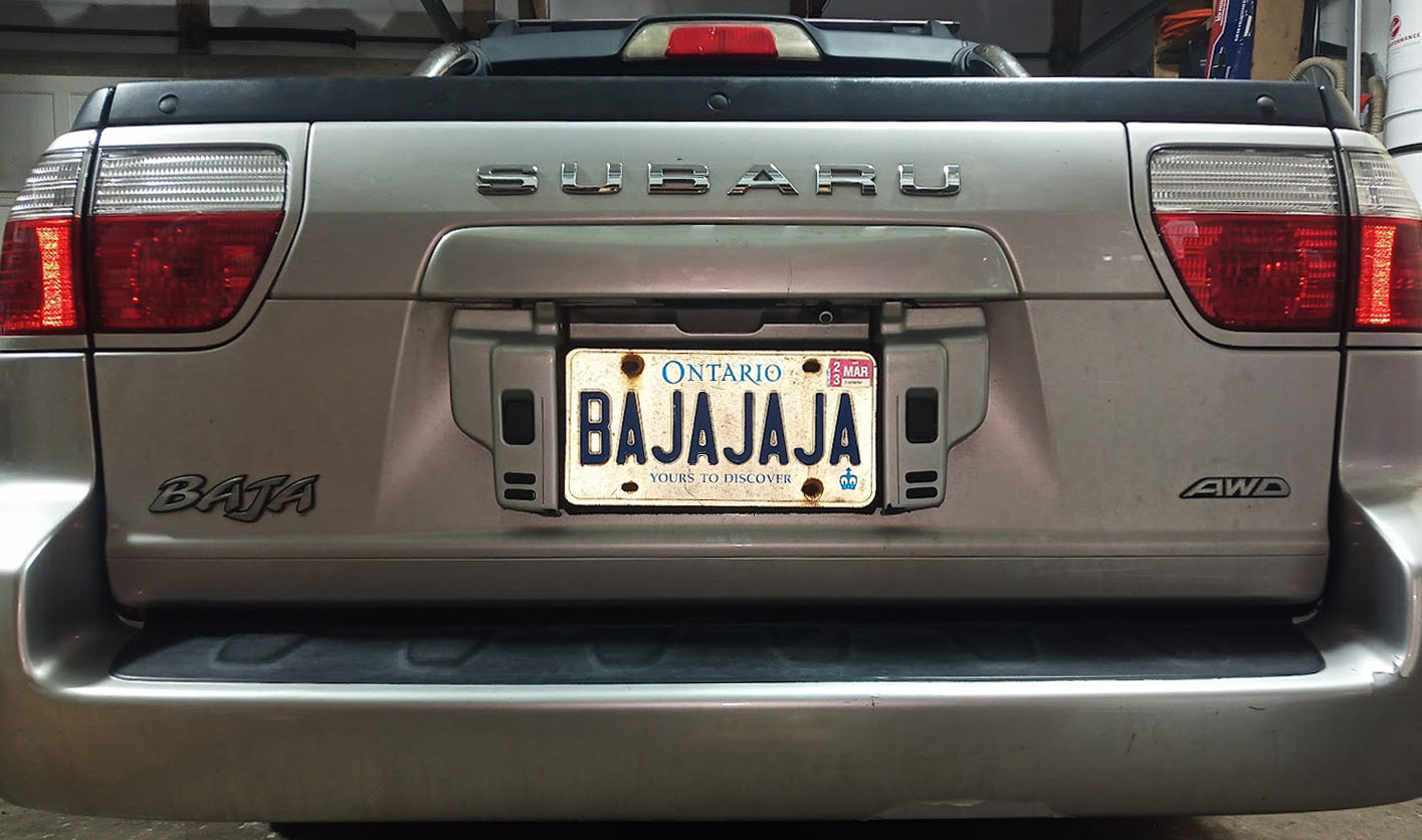

Had the Baja repainted and as part of that the BAJA, SUBARU, and AWD nameplates got ripped off. Could I trouble one of you to take measurements of your tailgate so I can put them back on in the same spot?
Posts: 416
Re: Tailgate Nameplate Locations
I can take some measurements likely today or tomorrow, unless someone gets to it first, but for now here's a couple of photos of the tailgate.

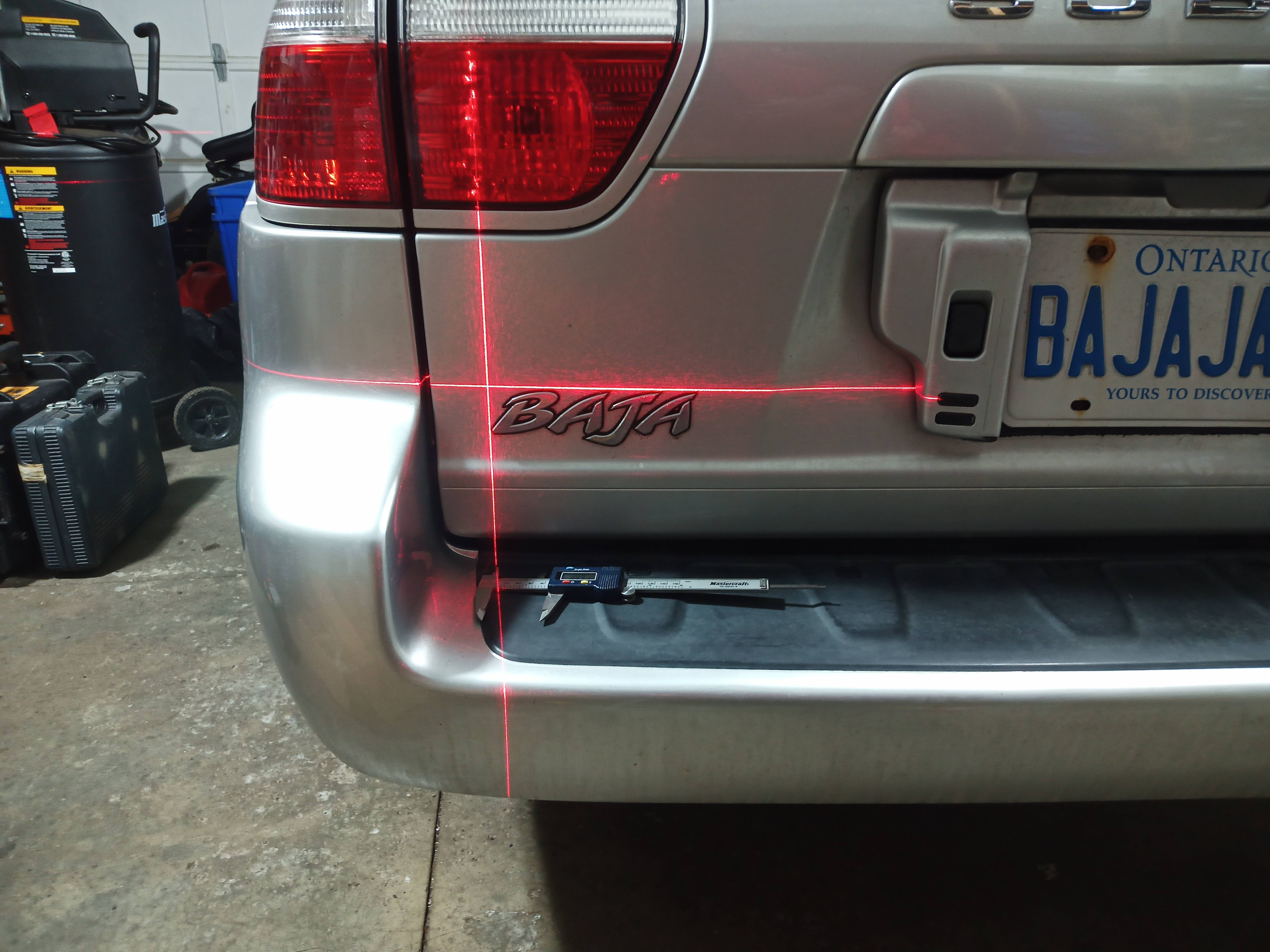

"BAJA" Badge:
45mm from left tip of "B" to left edge of tailgate
117mm from top-left corner of badge to bottom of tail light recess
Lines were drawn with a laser level, and looks like the highest points of each letter are all horizontal/parallel to the ground
(See photos)

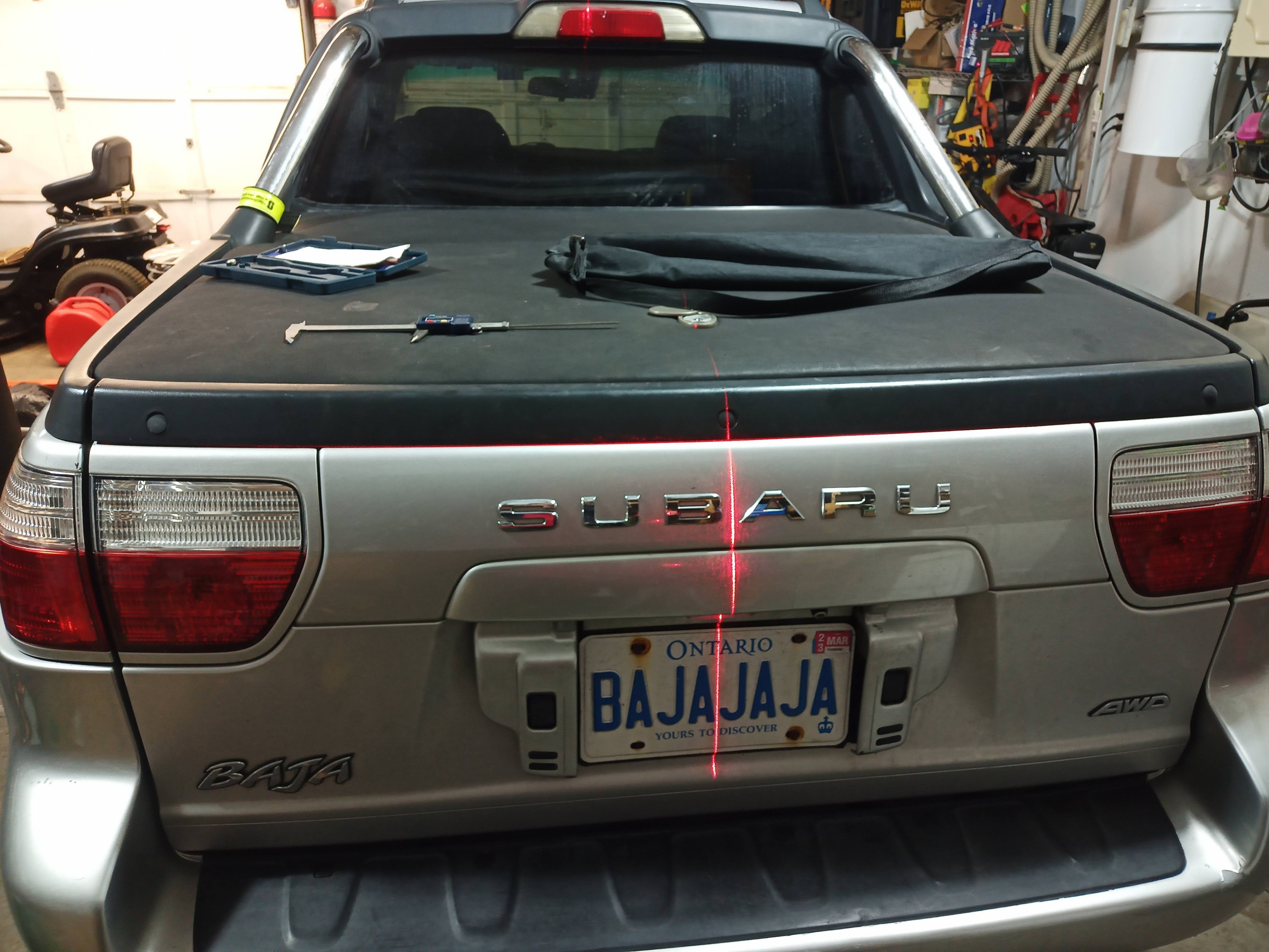

"SUBARU" Letters:
50.5mm from top edge of letters to top of metal part of tailgate, measured at the center of the tailgate (based on center of circular plastic trim piece fastener)
The top edges of all letters are coincident and horizontal

Posts: 416
"SUBARU" Letters cont'd:
5.7mm from vertical center to bottom-left corner of "A"
11.2mm from vertical center to right edge of "B"
16.9mm from right edge of "B" to bottom-left corner of "A"
