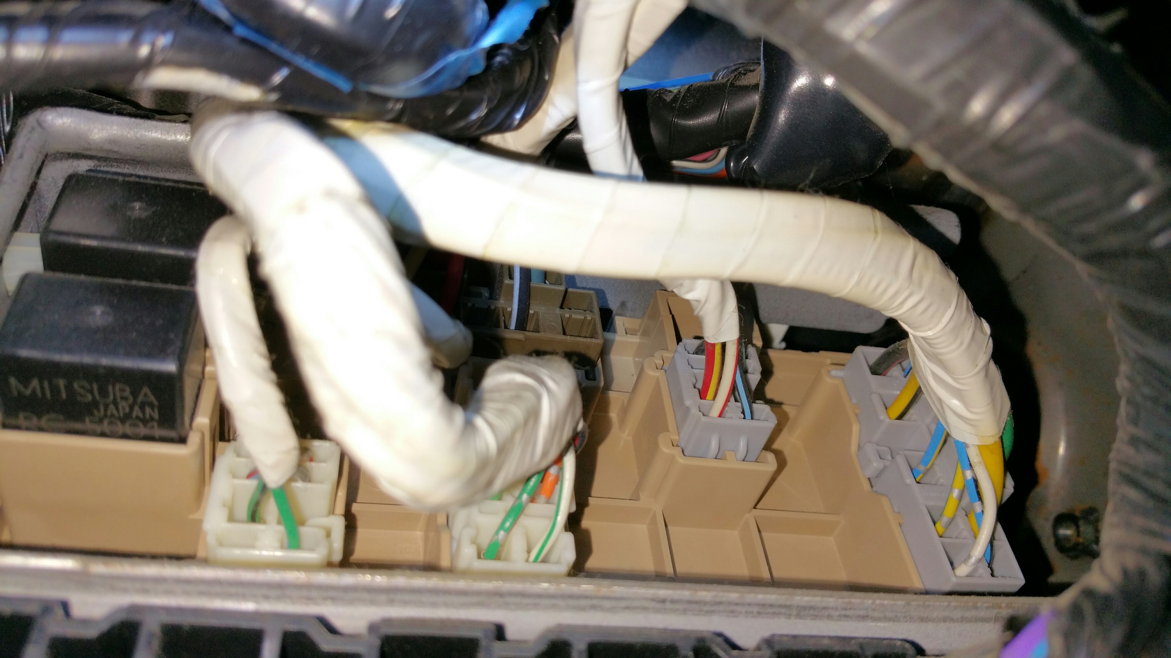

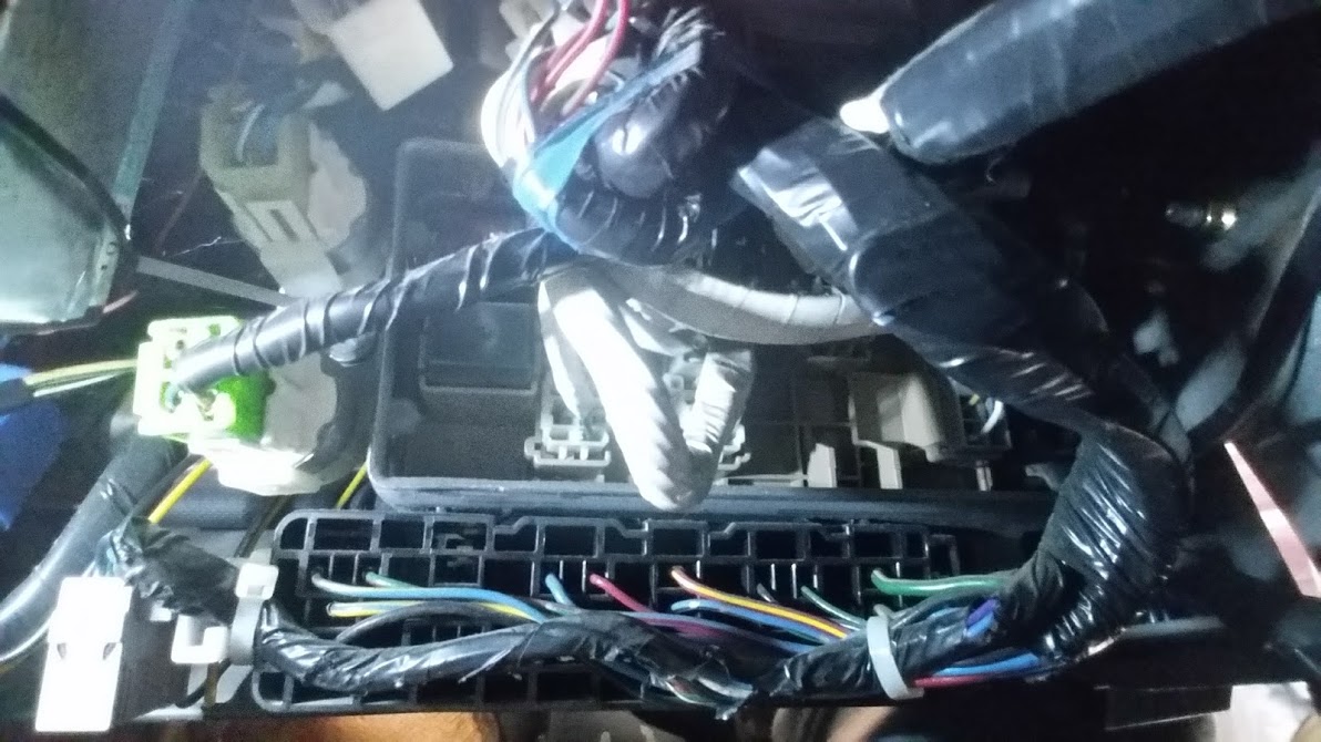

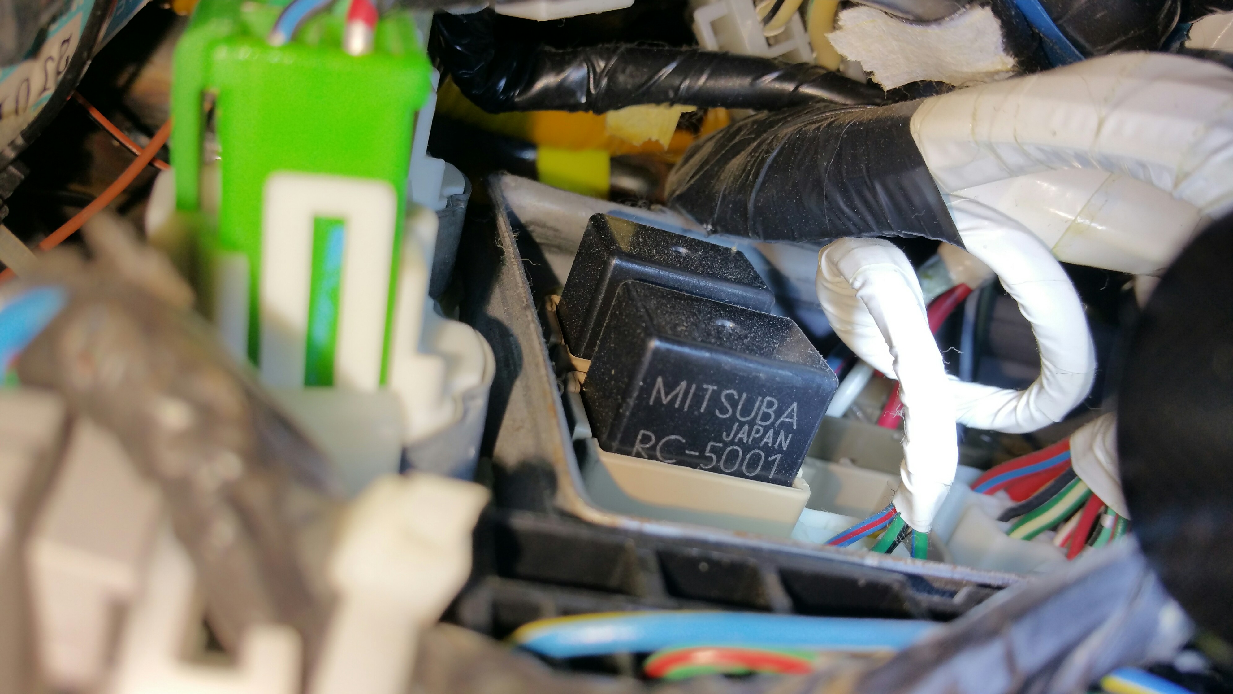

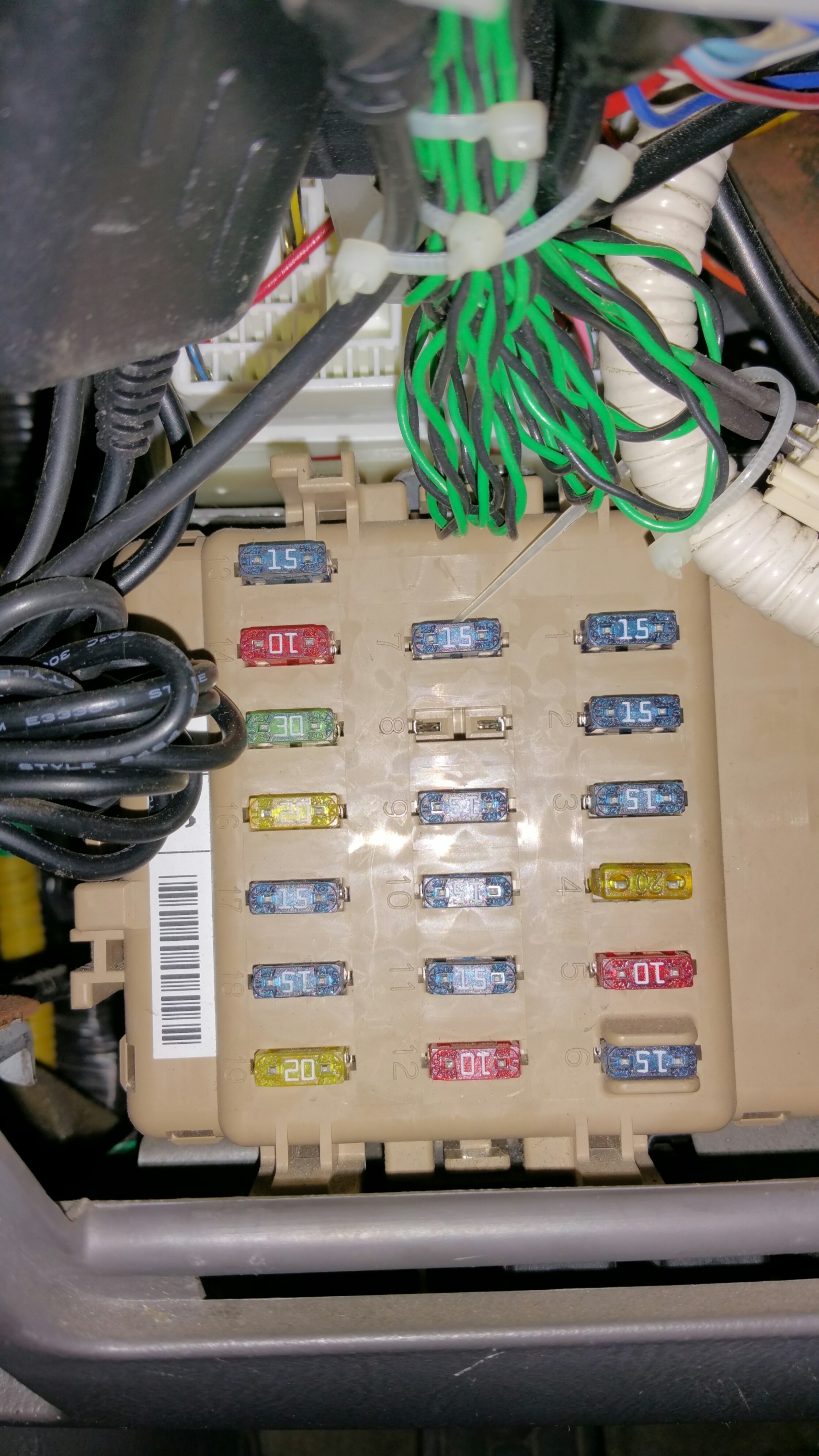

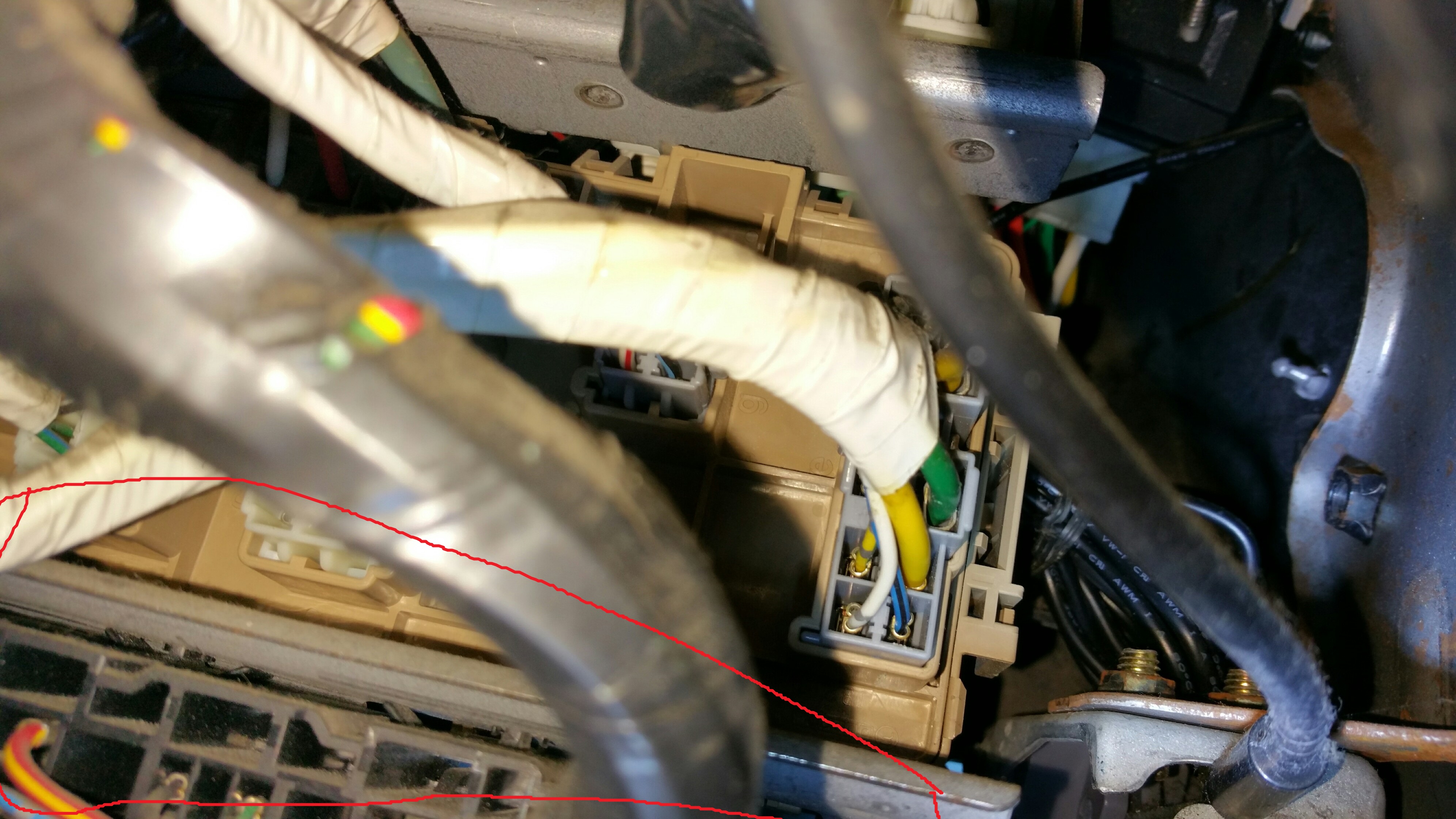

Can you take a picture of the pack of relays under the fuse panel inside?
You will have to put the camera under the dash and point towards the seat.
My US 03 has 3 relays, and the spot that's supposedly for the deicer is unpopulated, but the location changes based on what year manual you look at.
Re: Who has a heated windshield?
Sure, I'll take some pictures later today. Mine is also an 03; Canadian model.
Pictures

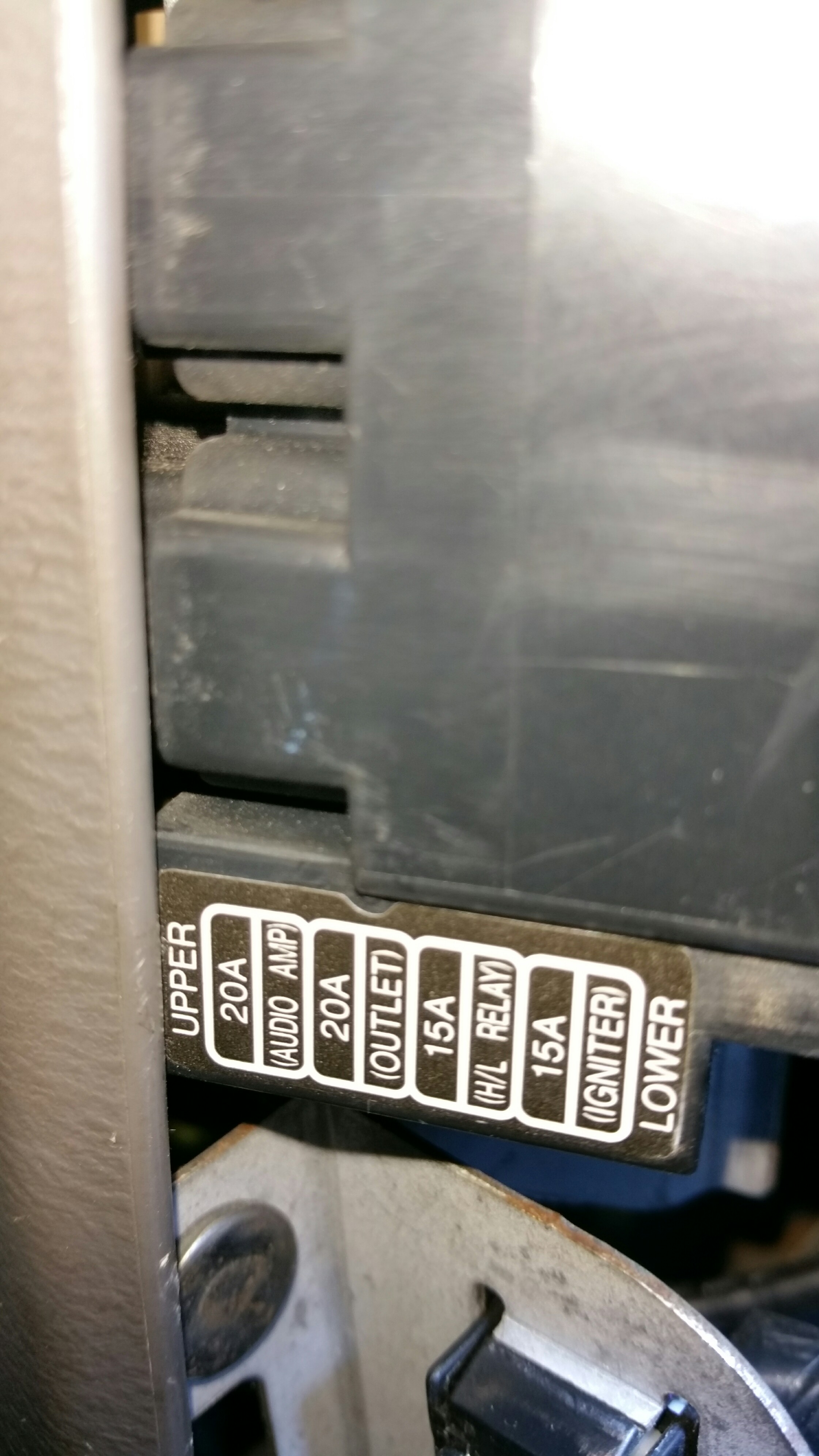

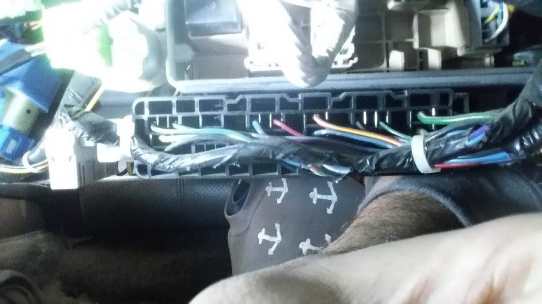

Can you get one more of the this?
20170225_095640-3984x2241 2.jpg (1.46 MiB) Viewed 20634 times
Sure, I'll try to get that tomorrow.

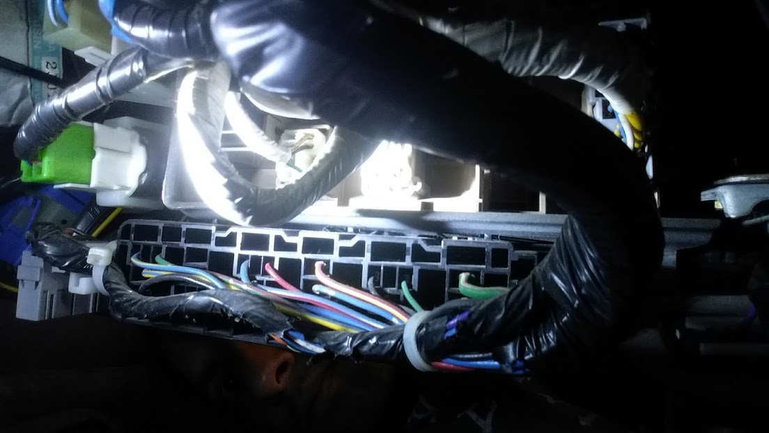

I had to use the front camera to get these photos, so the quality isn't as good as the others...

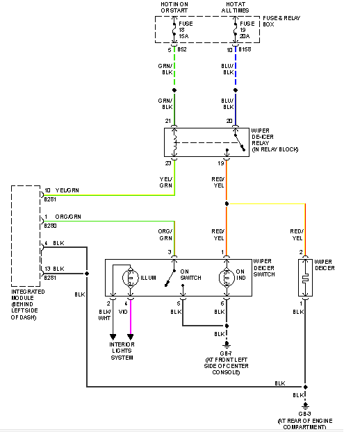

Also a diagram, if you don't have it already.

And that confirms it... The 2003 Bajas have none of the wiring needed for heated windshield or heated mirrors. :(
That's unfortunate, but since the circuit is relatively simple, it should be possible to run wiring in parallel with the existing harnesses.
