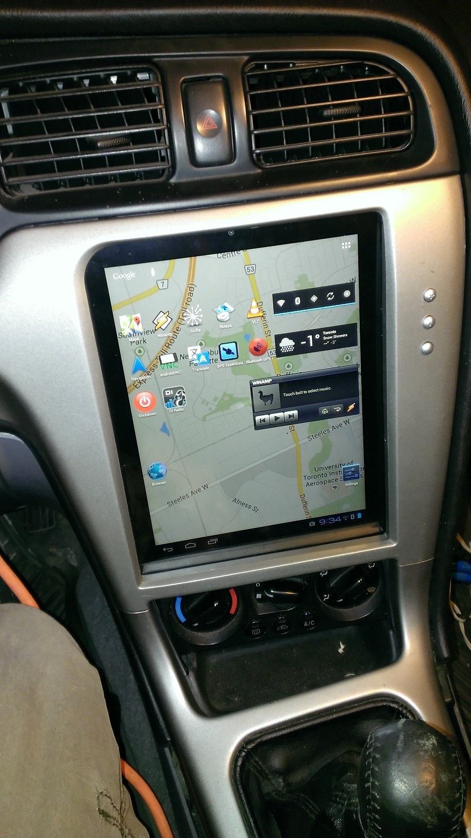

Zombaja wrote:is there such thing as a head unit running normal Android instead of the "android for radios" or whatever proprietary built in stuff (like AppRadio) where I cannot simply load apps like I do my phone?
There are, and my friend got one for his Acura. The feature set was pretty rich... GPS, BT, 3G/4G, dual MicroSD, CD/DVD, rear-view camera, various audio/video inputs and outputs, accelerometer, etc. It ran a regular version of Android, just as you'd expect on a tablet.
The main problem with his is the performance; he could only afford one with 512MB of RAM at the time, and that's just nowhere near enough for a modern OS + applications. Absolute minimum you'd want is 1GB, ideally 1.5GB+.
Or you can just do what I did and go with a complete tablet:
Doesn't offer rear-view camera abilities, but I have a separate dash cam that records front and rear video, and also functions as a rear-view camera.

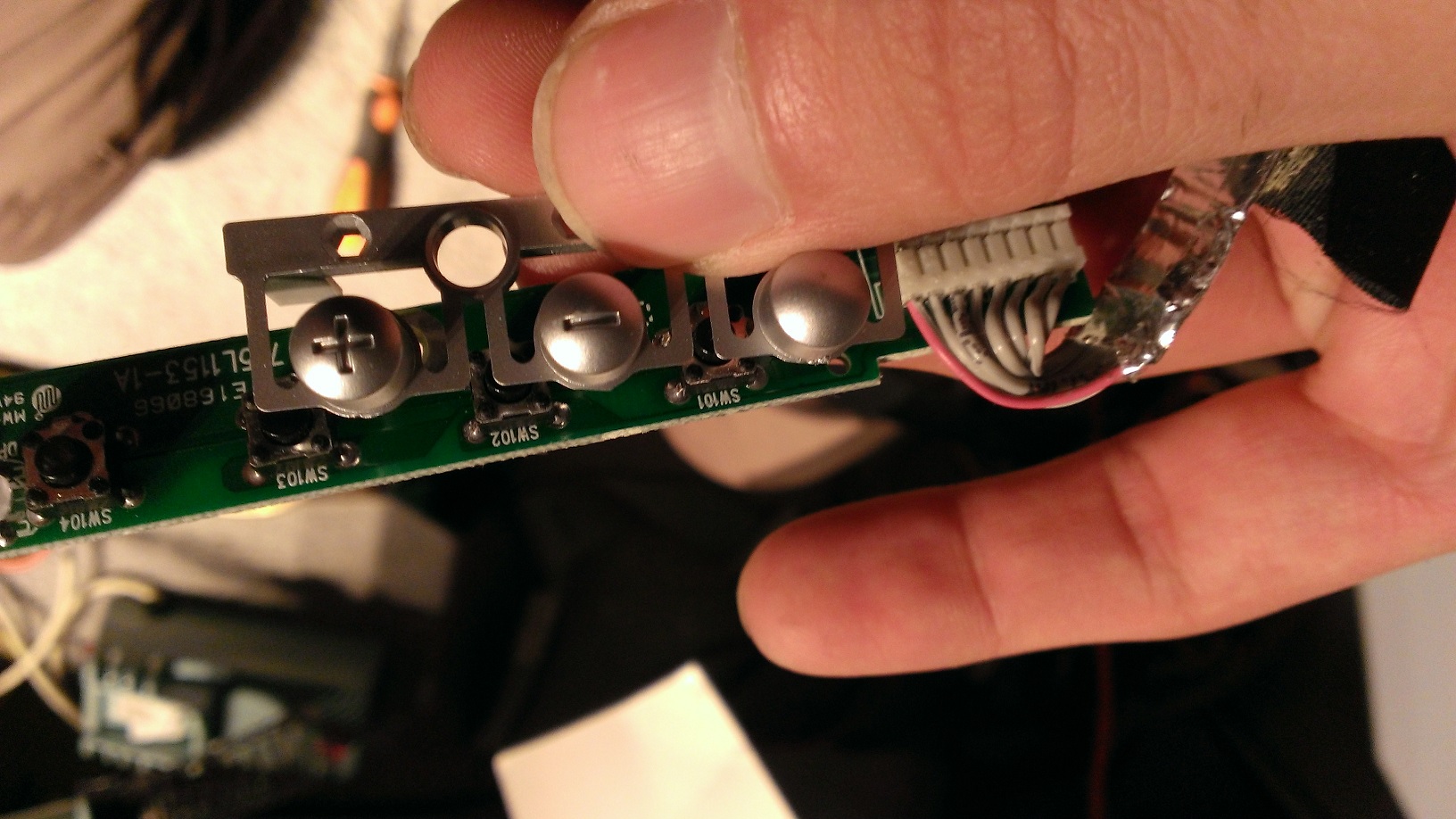

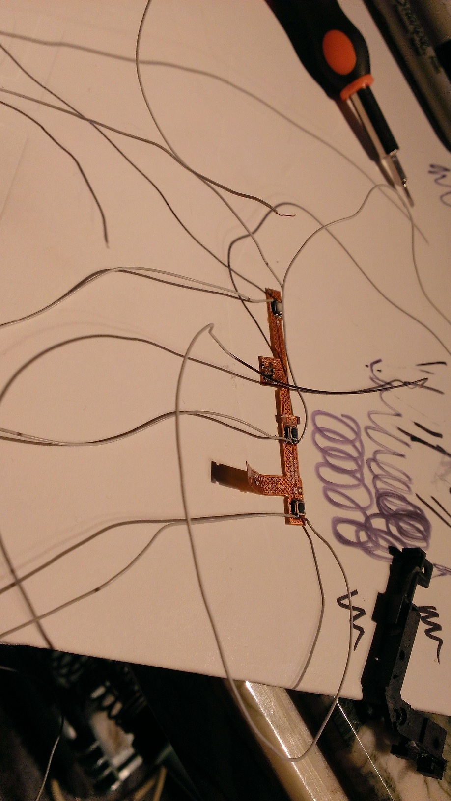

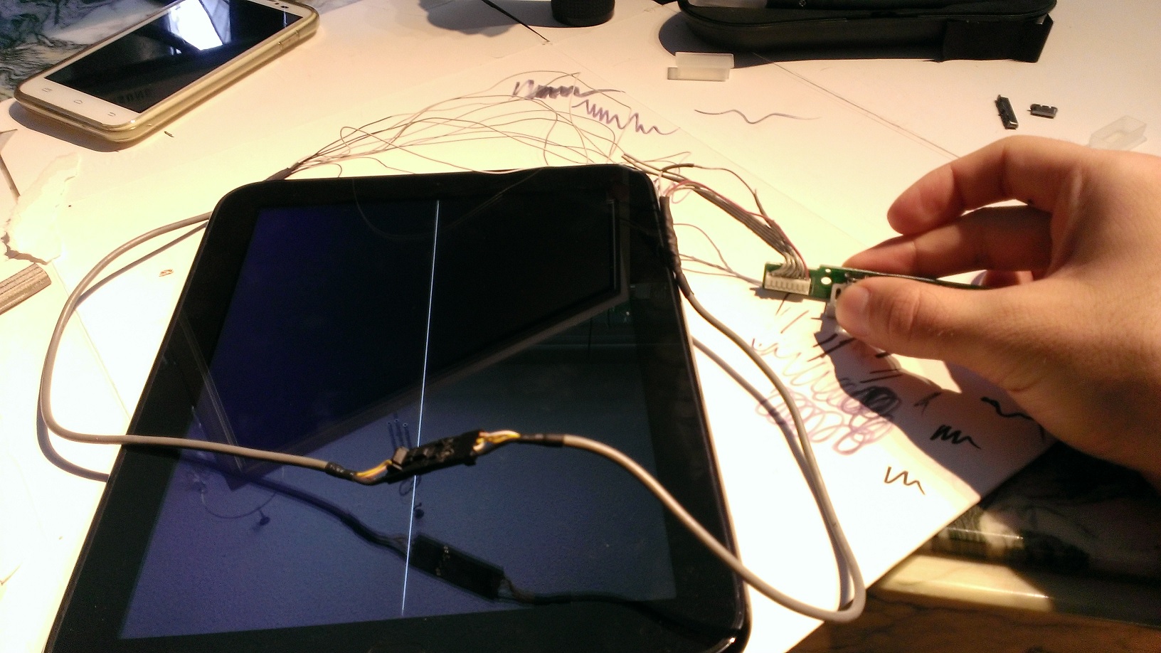

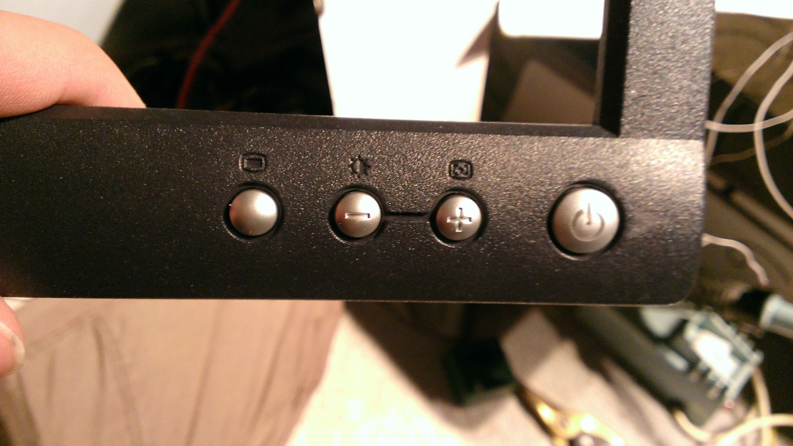

Where did you get the buttons from?
Posts: 413
Re: Double DIN head unit w/backup camera
I got the buttons from an old Dell LCD monitor, and soldered the wires to the buttons inside the tablet.
Posts: 413
Button board connected to tablet.
